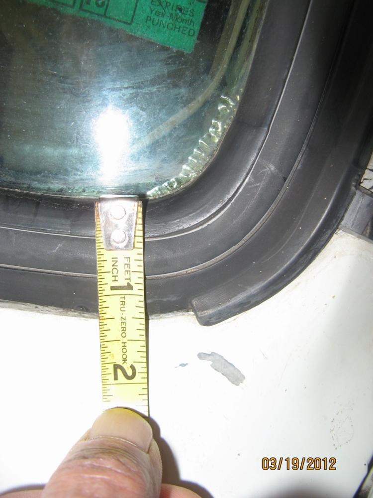

Not sure if you knew or not but the windshield gasket is different on the vinyl top cars, and it's not being reproduced. It has a different lip on the outer edge where it meets the vinyl, probably not a big deal though. I think the top looks great!
Yes & have that gasket but will not use, my cuda will never be in a concurs de what ever so not concerned. Had the fortune of stripping a wrecked 66 cuda with vinyl top & 273 commando back in 2003. Passenger side trim was toast but stripped drivers side trim, drivers side rear roof piece & windshield gasket but was short complete set. Commando engine from 66 doner car is is now in my valiant.

When I bought my 66 Barracuda last year, the factory vinyl top was toast from the NM sun. After considering many options, I finally decided to let my upholstery man do what he said he could do. Order a white vinyl top from his source that supplies most all cars that would closely match the original grain pattern and install it. Apparently the standard distance between the "seams" is like 40" or so which matched what was originally on my Barracuda.
Now, the windshield gasket is different on vinyl cars, but believe me, the non-vinyl top windshield gasket works just fine. No problem in appearance or function. The upholsterer removed the windshield and back glass (At the same time, he also installed a new headliner and that requires removing both front and rear glasses)
I not sure what SMS will charge for a vinyl top, but you might shop around before buying. The material is not that expensive if ordered from many suppliers.
Bottom line...I paid a total of $550 for: a new installed vinyl top, removing and reinstalling both front and rear glasses and installing new gaskets and installation of the headliner. (I supplied the headliner and front and rear gaskets, he supplied the vinyl top)
My car was originally ordered with a white vinyl top over white body paint which, while not a necessarily stunning combination in appearance was a good choice for the Roswell, NM owner.
I guess if I had it do over, I would have done the same thing...but I like to keep em original as possible.
A couple of picts. The car and a closeup of the extra lip on vinyl top windshield gasket...it has a 1/4" extra width around the side and top where overlaps the vinyl. But again the non-vinyl works fine.
