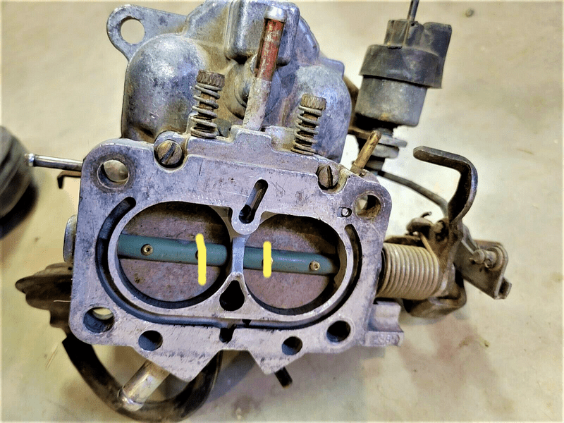

Between yellow lines is low area for air to pass between bores, this is in addition to air from open area center of base gasket. So there is some interaction between bores, just not in manifold. One thing that carb has no notches,later carbs did.Will need base gasket with notches
newer carb notches line up with throttle shaft
If you have the notches (as shown in the photo) then the manifold gasket is *not* supposed to have notches (and vice versa) ? Do I have that right?
And what's the deal with manifold gaskets (or maybe they're called flange gaskets) that are really thick (like 5/16 with metal sleeve inserts) vs 1/16 ? My current bbd has the thicker gasket, the repop I just bought has a couple of the thin gaskets (with notches) - no idea why they sent 2.
Since these carbs have spiral throttle return spring, do you still need to use the original long return spring also?
If you have the notches (as shown in the photo) then the manifold gasket is *not* supposed to have notches (and vice versa) ? Do I have that right? Yes you do, That passage draws vacuum from both sides of carb,feeds
choke pull off etc. needs to get vacuum signal, make your own notches in gasket if needed. And if need too use notched gasket with notched carb.
And what's the deal with manifold gaskets (or maybe they're called flange gaskets) that are really thick (like 5/16 with metal sleeve inserts) vs 1/16 ? My current bbd has the thicker gasket, the repop I just bought has a couple of the thin gaskets (with notches) - no idea why they sent 2. The 5/16 gasket with metal insert is correct one. Insert so gasket is not crushed,thickness for heat block, keeps carb cooler, and matches length of choke rod.With thin ones choke rod too long.

So I'm basically asking here, was the gasket in the top photo the correct one to use on the carb in the middle photo, even though it completely blocks off the ports in the red box.
My second question is - explain the difference in how the ports in the red and green boxes are arranged with regards to having an open path to the intake manifold as determined (or not) by the gasket.
The new repop carb I'm putting on does have notches on the left and right side of the channel that allows a path from the channel to the intake (the carbs above do not have the notches). The new gasket is thinner than the one in the photo but is cut exactly the same.

Green box vacuum to step up power piston, red box do not have carb to look at older carb. See were passage goes
