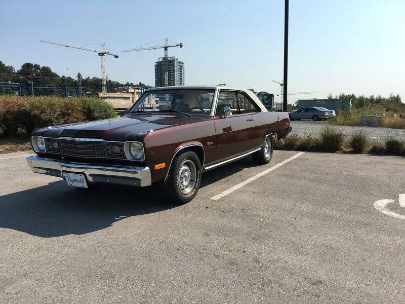

I run 235/60/14 all around on my 75 Scamp. I don’t think I could have gone wider on the front since the inner shoulder of the tire is less than a 1/4 inch away from the front sub frame rail when the wheel is cranked over.

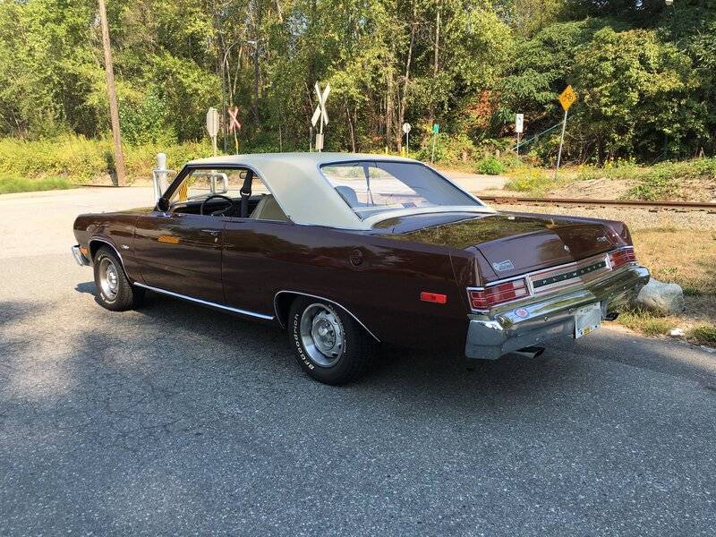

Here’s my Scamp with 235/60/14’s. When I replace these tires I will likely go with 215/70/14 tires all round. I find the fronts stick out a little too much for my liking with 235’s. I realise that down the road (following tire change after this one in about 7ish years) I’ll likely need to upgrade to 15 inch rims since 14 inch tires will be even more scarce then.
