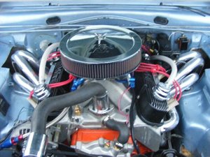

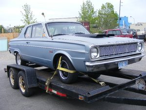

Ok guys, lets toss around some "bullet proof" low budget early A-body rear end ideas.. Here's what I'm thinking, I just stumbled out in the dark and measured a mid-80's gt stang rear end I just happened to have laying around.. It's approx 52.5" back plate to back plate... I have a 66 Valiant thats getting a 383... What do you guys think about going with a late 80's GT 8.8 posi stang rear end in my Valiant??? Cut all the ford mounts off it and weld on 2-leaf spring perches..
