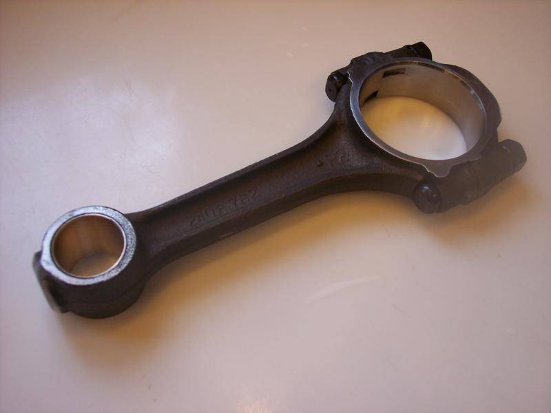

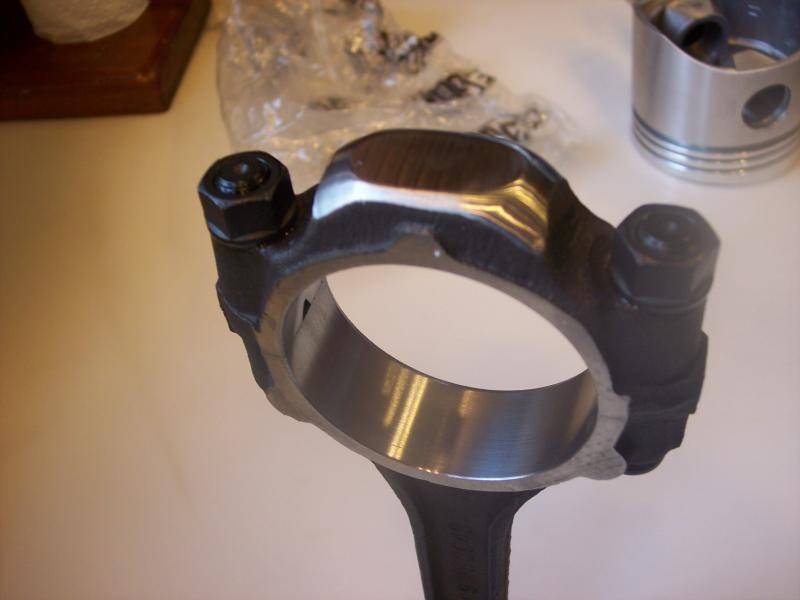

Steve @ Dewar Machine did mine. With new bolts they were perfect. toolman
If you buy new rods don't assume they don't need to be checked/resized or have the pin to bushings sized properly. It makes rebuilding the stock rods the cheapest option still.
