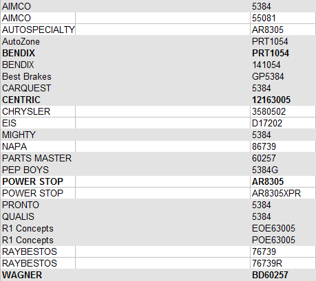

This is a cross ref list I got from a now defunct website. I can't vouch for all the numbers being correct or quality of one vs another. But it gives you p/n numbers to look for when the stupid look up table on a computer says there is no brakes, or no disk brakes for your car.
