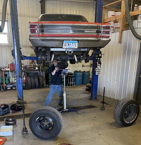

That’s the way to slam dunk a third member in. It’s a bit of a PIA on your back since there a bit weighty.
