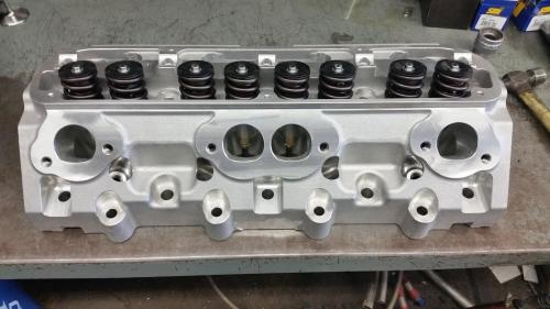

Oh, so can you run the P-7 MP head on a production block?
I'm not familiar with the P-7 head. Some heads are designed for 48° blocks and others are designed for stock 59° blocks.
those bolt holes look awful low in relation to the exhaust ports.
are header gasket blow outs common with this style head? ( I realize these were just released )

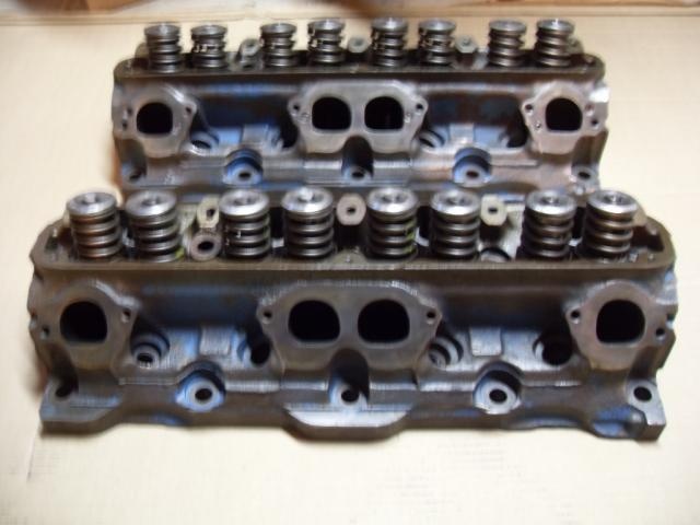

so what exhaust do you run? They are not even W2 pattern? W5? These look very close.
attachment.php
attachment.php
TTI is making the headers for this head and A bodies....1 7/8 step to 2" with a 3.5" collector.
With their 3/8 flanges, shouldn't be any problem with gasket sealing but we'll see...
curious to see the flow numbers on these

Can't wait for you to get them sorted , I'll be saving my duckies for a set of these to replace the RHS heads you put on my motor , Yes I am ready for more power .
So those have to go on a R-5 block? I see it has a bottom row of bolts.
A bottom row of bolt holes does not automatically mean 48* block. The can be cut off for a standard block/standard header if it gets in the way.
There modeled after the W5 exhaust. The intake boots are wider, AKA, W5, as per the advertisements.
The Intake is STD. LA....
Will there any piston issues with say just the average scat 4 inch rotating assembly
Normal Pistons have valve reliefs for 18*'s (stock)
These have 15* valves. There could be an issue.
Thanks for the correction on the intake issue.
