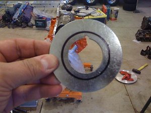

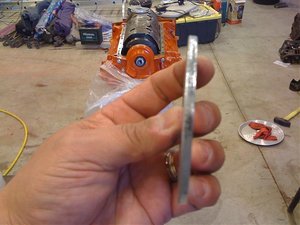

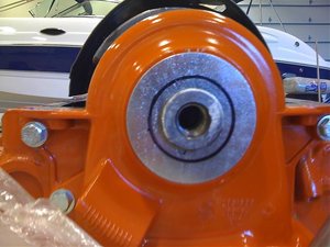

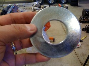

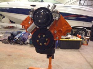

I noticed when putting on the oil pan that the Damper was not up against the oil slinger/timing gear... so I ended up making a crank spacer so the Damper would push up against the oil slinger/crank gear and not hit the timing cover. Good thing I caught this. I dont know as of yet if the crank gear that is a CAT Gear Drive set up is thinner than the original crank gear is or if the Damper is a little shorter on the snout. I will take some measurements and post my findings.
Here is the spacer.....

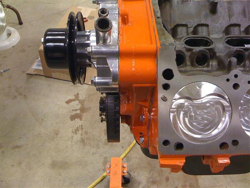

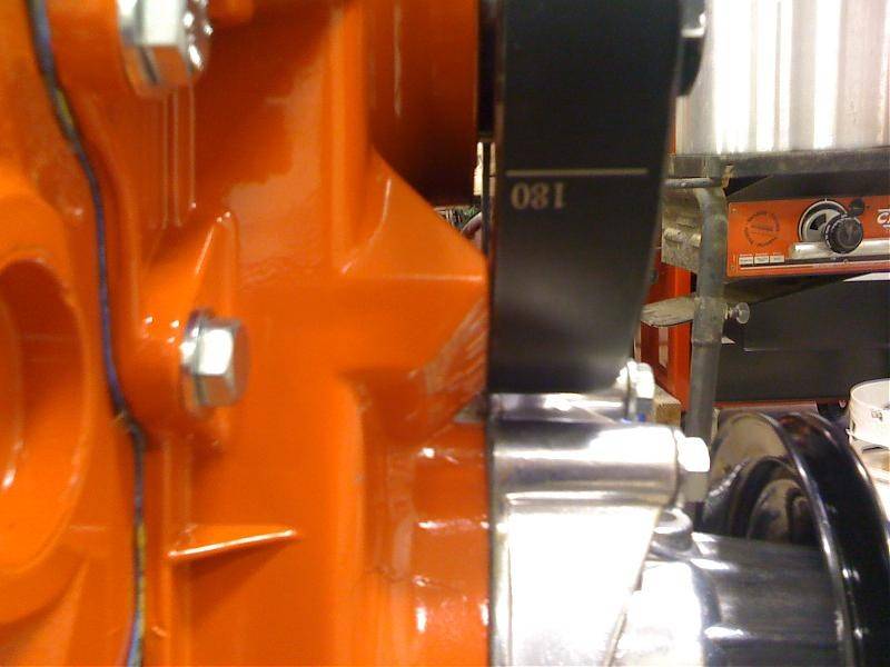

Ok, this is what I found out.
The snout of the Damper is about .150 shorter than the other Damper that I have to compare it to.
The Spacer I made is .160 thick and I kissed the timing marks on the face of the timing cover with a file about .050, I checked the crank gear this time as I tightened up on the installation tool and made sure it was gonna press against the spacer I made. I had to use an Impact to get it on the rest of the way in the end. I could see and feel this time when it was snug as a bug against the crank gear. All the pulley's etc will line up fine. I couldn't measure the crank gear that is a CAT GEAR DRIVE because of the front cover being on already.

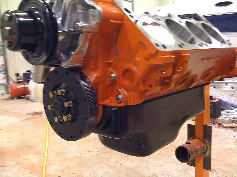

Humm... Why can't they just make these balancers the same size stock ones were???
No kidding.. I looked at Hughes site and they sell one from PRW but it looks like it is the THICKER version that most everybody has a bunch of problems with, alot worse than this one.
If you used an older timing cover without the timing marks on it, you could slide it right on but then you would have to either space the pulley out or have a different one made and use a timing pointer........billett????
I at least let everyone know what to expect and how to get around it if this damper is going to be used.
I still like the damper and if I use it again on another build, will know exactly what to do to make it work the first time!!!
So if you know a machinist or want to make your own spacer, the magic number so far is .210 as the thickness! Then you wouldn't need to kiss the timing marks off the cover. This is with the CAT gear drive, dont know about a regular chain set up.

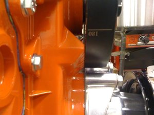

UGH!! Seems no matter how much research you do on these things it's a crap shoot. According to all the information I found it should have been real close to the stock balancer dimensions. But, I installed it today and it is the exact opposite of yours. It has a .475" gap between it and the timing cover (I checked to make absolutely sure it was pulled up tight and it was) meaning it's going to throw my March serpentine pulleys way out of alignment. I have a buddy that'll machine the snout down for me so it's not a big deal but according to my measurements even if we take .425" off (I like to have at least a .040-.050" gap) it'll still put the bottom pulley out about 1/4" farther than the stock balancer does which means making a spacer for the fan pulley, spacing out the alternator and power steering pump. Along with that comes having to change fan styles because the Mopar viscosus (sp?) barely clears the radiator now so I'll probably have to go with a thin flex fan. And to top it off I indexed it and it's 3 degrees off.
The picture is with it pulled all the way in. It looks like more than .475" but that's what it measured.
Louis if you take yours off again for any reason do me a favor and measure how much the snout protrudes from the back of the balancer and let me know please. I'm curious if their made the same. They should be since their the same part # but you never know. Thanks, Tracy

No hurry at all. I probably won't even do any more to mine until monday anyway. Yeah I'm running a ProGear chain from Hughes. I don't doubt it's some thicker than the Cat gear but not 3/4" thicker which is just about what it'd have to be since you had to have a .210" spacer just to get it to clear the T. cover and mine is out almost 1/2" past the T. cover with no spacer. It sounds like your PRW balancer is different dimensions than mine, but that's just my guess. Since I bought mine over a year ago and you just bought yours they would have had time to change something.
Tracy,
Is your pan still off? If it's on maybe look thru the fuel pump hole and see if you can wiggle the oil slinger. I thought mine was on all the way and it truly felt like it the first time I put it on, but it wasn't. It Fooled me good! It fits so snug that the last 1/2" I had to use an impact to get it against the spacer/ oil slinger and I boiled it the second time also.
