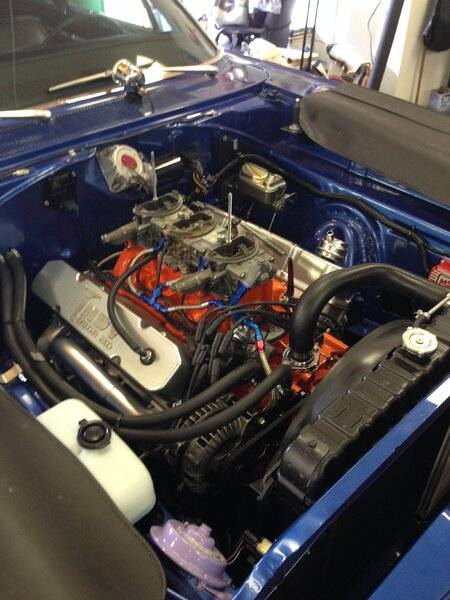

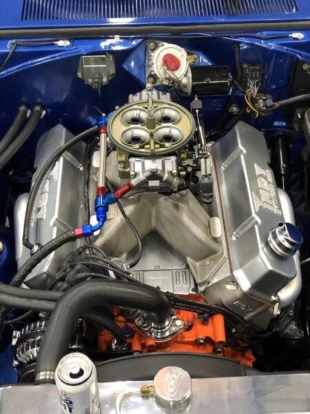

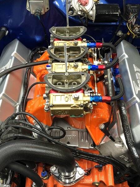

Actually that’s not BS. They can and they do in the right hands. I have a six pack that will run as good as most any single plane and 4150 carb. I’ve done it and ran about every combo on the car. This is on a high 10sec b body street car with a 500ci motor. About the only thing that’s been a bit stronger is a Indy single plane and a 1050 dominator. The vacuum operated six pack ran identical et to a heavily ported TM6 and a 4150/1050 carb.my mechanical six pack is really strong. I think it would be within a tenth or two of the Indy single plane. Granted I build some custom carbs so I probably have a bit of tuning advantage.

But he is comparing BB vs BB vs BB.
Displaying doth combinations of 4 & 6 bbl.’s.

How much time do you have in porting the six pack manifold?

granted I haven’t ran any healthy small blocks but I’ve had the SB intakes. I didn’t think they looked all the bad. Certainly I would do some serious grinding on one before running it but, I just don’t see it being a blow out. But I suppose I’d be willing to go above and beyond If that was the route I chose. But again I don’t have that first hand experience and it’s possible it just sucks. Now comparing what it costs to run one compared to a single 4 doesn’t make sense… lol
I have had this exact same argument over the big block six pack as well which I have proved inaccurate. So I’m always a bit open minded to their potential.
hard to say, I’ve modified it a few different times experimenting with it. I’d say I probably have 3-4 hours in it. Working on the area under the carbs really made it happy on the big motor. I haven’t ran it at the track though since that mod. I’m not a put something on a car and leave it alone type of guy. I’m always experimenting and playing with stuff. Lack of any safety equipment in the car makes it hard to run at the track to get data though.
I want that done to my B engines 6 pack.
