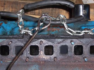

There are 2 bosses cast in the head between the valve cover and the intake/exhaust just for this. They are already tapped 3/8" coarse thread and look something like this......

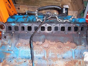

Using these lift points puts the nose of the engine slightly up with a transmission attached at almost an ideal angle for lifting over the radiator support. Make sure you drain the transmission first or you will have a big mess when all the fluid runs out of the tailshaft. The next picture gives you a better idea of where the bosses are on the head. Hope this helps.

Sorry to revive such an old thread but I find myself facing the same questions.....pulling a slant 6 from a 1980 Volare.
Those two little bolts are adequate for lifting the whole engine out????
And would there be any issue in not pulling the transmission at the same time?
No problem with not pulling the trans... that is my general preference.
And yes they will hold.... use grade 5 bolts or better. I suspect the factory process would be to use both bolts to mount a plate with a hole in it for a hook. But, I am kinda like you..... that seems pretty lightweight, and so I used a second safety chain loosely around the manifolds as a back up.

Story is the factory plan was a shop would lift from only one of the holes, front hole for engine alone, rear hole for engine + tranny. But, seems smarter to use both and a leveler. I am cheap so just use a turnbuckle between 2 chains to adjust the tilt. Coming out the top, you will need to remove the hood. Best to drill 2 small alignment holes in each side before you unbolt it, otherwise you will spend hours trying to get it aligned again. I understand, the factory had a guy inside the empty bay to tighten the bolts when they fit the hood. If you need to rebuild suspension and steering, consider pulling the whole K-frame w/ engine out the bottom (tranny too) by lifting the car body up and rolling the assembly out. Search for posts w/ photos. I think the factory installed them from the bottom like that.

I bought some bolts and washers this morning for lifting....they had some heavy angle iron at the hardware store I almost bought to make my own lift "plate" but decided that since others used just the bolts I should be OK.....crossing fingers. LOL
