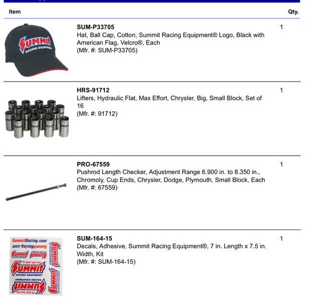

Ok lifters bought and also grabbed some swag. I’ll pop them in and do a measure with the factory rockers. Then we’ll take a look at push rods. My stamped factory rockers may just be adequate with that cam but those aluminum roller rockers are enticing and probably better option.
The factory stamped rockers will want a ball end, not the cup end that’s on the measuring tool you bought. Aluminum rockers will likely use the cup end (but not always)…maybe use that as your motivation to get those rockers you want;). Also, I don’t know big block typical length, but that measuring tool is listed for small blocks.
Dammit. Lol I was eying up the Mancini rocker setup. That tool was listed as having one of the larger measurement lengths as a quick Amazon search netted smaller max lengths. Not sure it shipped yet and could cancel that tool unless you think it will work with that setup in the link. Thanks for your input

Flat out, I don’t know enough about big blocks to provide enough assistance other than to know cup vs ball and that they have a longer distance from lifter to rocker than small blocks.
Mancini shows a set of pushrods at just over 9”, which would mean the length checker you ordered won’t work. But, you should really check with Mancini or someone on here might have more experience to better guide you.
Here’s a link to a Mancini set for an RB with hydraulic lifters for reference:
Mancini RB Eng, Hyd. Pushrod Set, Chromemoly
Hopefully you can cancel the checker before having to pay to send it back!
Here’s the longer version, maybe they can swap it in the order:
Proform Parts 67557 Proform Pushrod Length Checkers | Summit Racing
And………….. the truck has left the building with the small block tool. So this is a good lesson to learn. Just because it pops up as the recommended tool read the description so you get the right tool. Computers aren’t always right.
So now I need to build a small block engine after the big block is done to justify my wrong purchase. Just cost myself 5 grand

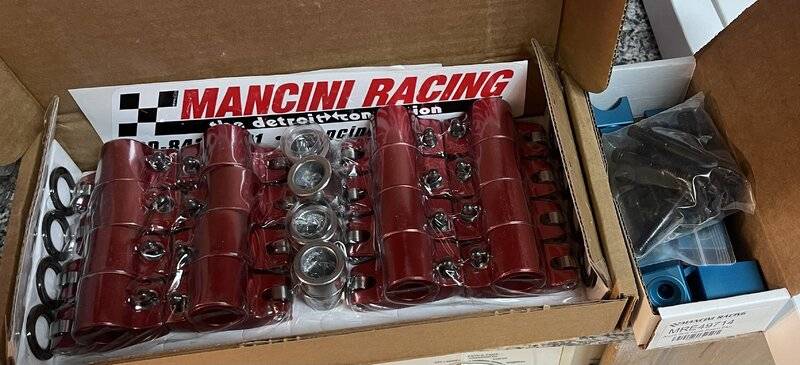

Ordered my rockers today and went with the Mancini Racing Aluminum Roller Rocker Arm Kit 1.5 with billet aluminum hold downs by Harland Sharp.

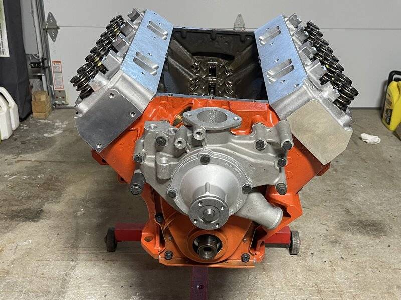

Installed the lifters, oil pump/distributor shaft and popped the plugs in loose to keep **** out of the bores.
Timing chain and gears should be here any day and that will get the front sealed up.

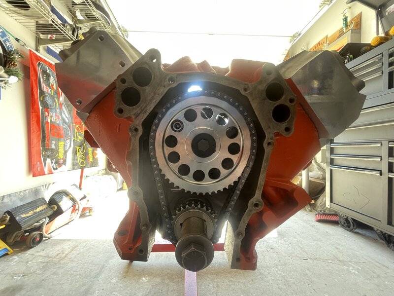

Timing set has arrived and was installed,
Oil slinger installed and cover installed.
Water pump housing and pump installed.
Fuel pushrod and galley plug installed. Went to National Moparts for a ton of hardware and some hard to get parts. Reconditioned the valley hold down plates. Also my rockers arrived yesterday and will be installed today.
Direct connection balancer installed also.

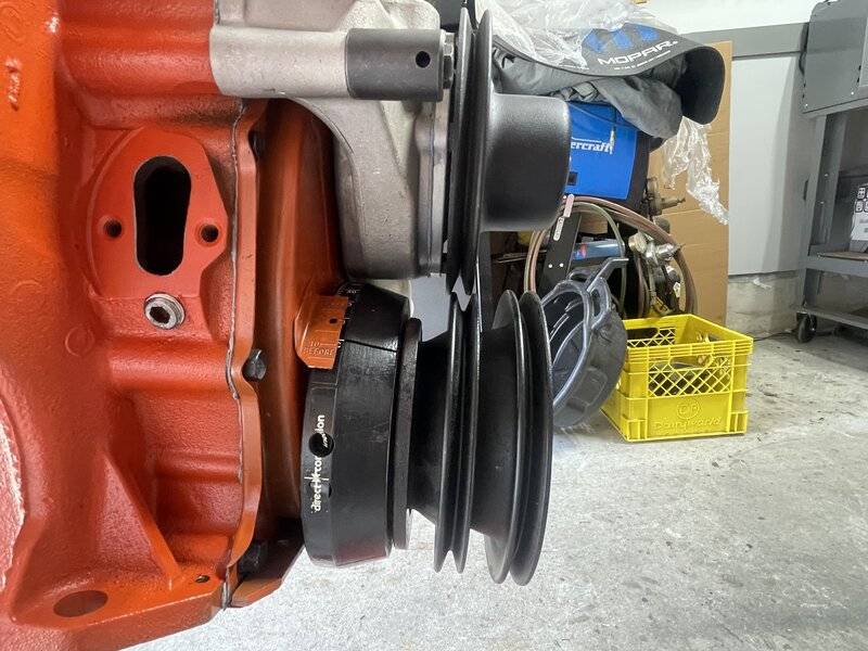

Pulley’s are way out of alignment and touching. Photos added.
This is the problem when you collect parts over the years and then put them together years later lol
Plugs and heater core inlets on pump ordered and are wrong. But I believe I have the answer to move forward. 2 5/8’s inlets and 9/16 and 1/4 Assuming the 1/4 is the sensor. 5/8’s the heater core inlets? 9/16 plugged?

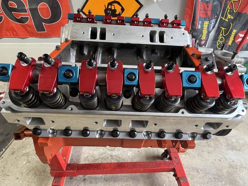

Ok Rockers are on and shimmed the best I could with the provided shims. I think a better shim assortment would net a better alignment. All rollers are on the valve but some are not centred perfect. The Mancini shims with the kit are all the same size. Each bank can take 1 shim but anymore you loose the 15-20 thou I believe they want. So every bank is 20. If I had a half size shim smaller than what the kit comes with I could really line them up nicely. I may look for shims. Torqued to 40 FP and we move on to measurements tomorrow maybe.
Shim kit has arrived and after a few more hours of shimming I like where I’m at. They look near centred and I’m moving on to other parts of the build.
