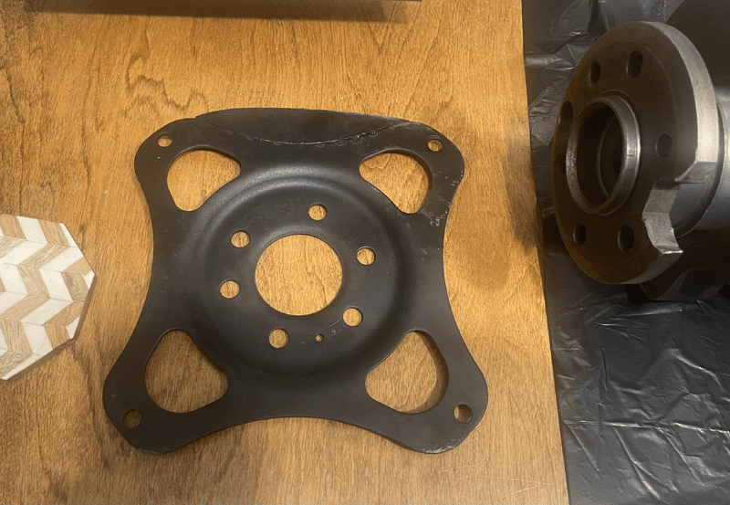

Ok...... Rotating assembly is back from the machinist. Lots of work done. The crank has seen a lot of welding adding material (weight). There was also a lot of shaving on some of the counter weights. The flex plate was also interesting as they welded in a plate to one of the 4 curved openings. I'm told now I'll be looking for a neutral balance converter. (3000 stall). We have a converter shop in the city that rebuilds them at an amazing price point and builds to spec! The rods and pistons had very minimal work needed. 3 rods needed a bit of attention to the sizing and one small end needed a hair removed. Thanks @oldkimmer I'll try and get photos up. The crank doesn't look pretty now but it's all balanced out. I guess that's the game you play when using lighter pistons in place of heavier ones. On the head front I called Todd Marsh at Marsh Performance and I have decided to go with a set of Sidewinders with some custom work done to them. I'm driving through Linwood NC in a couple of weeks and will pick a set up.

I gotta tell ya though that the flex plate mod kinda gives me the willie’s. kim

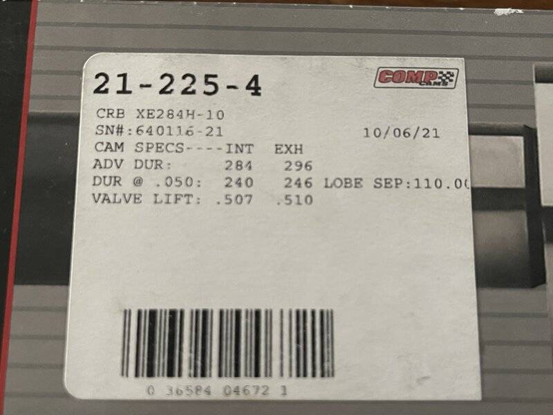

OK cam arrived and we’ll start assembling hopefully this week. Lots of cam and I should’ve went with one of the nostalgia cams. This folks is why you don’t buy engine parts when drinking. 16 days dry now. Lol

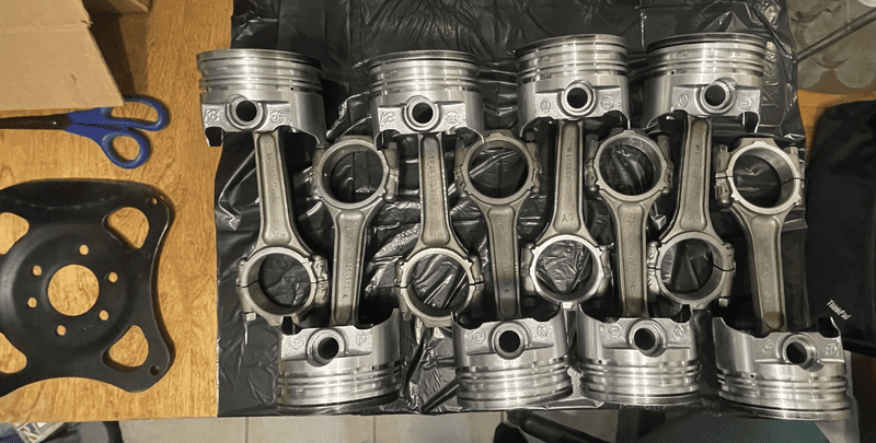

Alright we started on the rotating assembly. We hit a major snag and she’ll be on pause for an indefinite time while I check my options. This is why you always always always check to make sure the machinist did his job. I didn’t have the tools to do this but guess what I’ll be doing going forward. Now to deal with my 30 over block that’s actually 60. I will however get the rear end installed with the assumption that a V8 install is still on the books. FML LOL

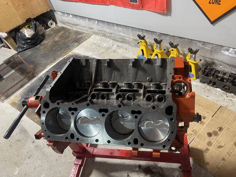

Well I have two choices now. Build a 60 over (cheapest route) or grab another 30 over block. Currently hunting for 60 over KB’s. See what happens. My “New” machinist came over today to put the nail in the coffin of my current build. I told him it just didn’t seem right, feel right and way to much play. He came over with his measuring tools and confirmed. Boy those 30 over pistons fit real well in them holes. Thought the gap look overly large. Lol
Pulled all the pistons and just going to sit on it for a bit.
Plenty of people run .060 with no problems.
