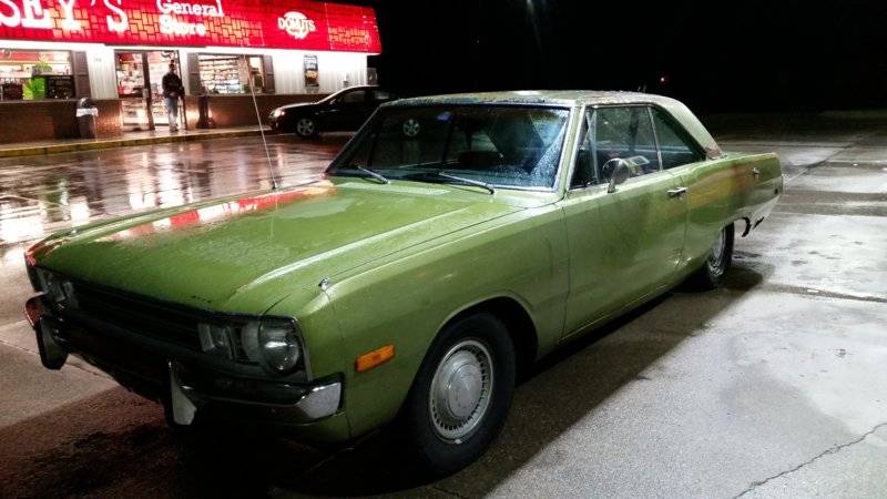

My dad and I left Wichita right about midnight planning on stopping somewhere to rest but we didn't. Made it into Webster City, Iowa about 6 am. So we got a motel room and slept till about 10:30. Chris, the seller, had messaged me asking when we would be there. I said, "20 minutes!"
Walked up to the car and it was pretty much exactly like I thought it would be except the interior was less faded than it looked in the pictures. The body and underbody were in better shape than I had hoped. The engine looked safely covered in 46 years of oil, grease and dirt. It was locked so we went in to talk to Chris and he met us with the keys and a gas can.
I put in the battery I had brought along and with just a little gas down the throat she fired right up. I expected engine noise of some kind but this 318 sitting in a car with 107,000 miles just sat there with hardly a vibration, it was loud because it had no muffler but is sounded great.

As the engine was warming up two things were noticed. Fuel was dumping all over the intake and the heater hose was leaking at the water pump. I put the new carb on and the fuel problem was fixed. Decided to go ahead and get the paperwork out of the way and head over to O'reilly's to fix the eminent issues.
Chris also has a 1970 340 complete Swinger car, and a very nice white Dart Sport. We talked for a little about cars and mopars. He said this had been a one owner car and he even said "typical little old lady". Got the title, put on my tag and headed off.

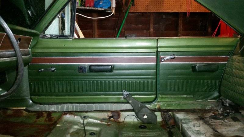

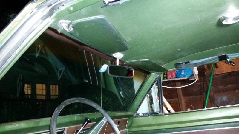

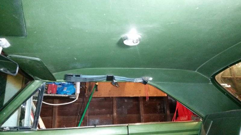

I got the wet interior out. If I had to guess, I think most of the water in the back seat well is from the quarter glass seal, that seems to be where it was coming from. Also the left rear seat belt retractor mount is almost falling off, that may have been sending water in as well, It may not look immaculate but I'm pleased with the condition it's in. I think I can get away with patching in these areas with holes. I'll know more when it dries out and I can take a clean up wheel to the front areas. The driver door has been replaced, I can see sublime paint under the window mouldings. Also they didn't get a great match on the interior paint color. It matches the outside but not the inside paint.
The seats are in good condition. The backseats are in fantastic shape and the front needs some attention. The front seat is also broken down on the driver's left side. I've got new carpet coming but not going with plush, I've always liked the look and utility of the loop carpeting.
First thing to do is to get the floor rust fixed. I mentioned at the first but this is going to be a rolling repair. I don't want to call it a restoration because that's not what's happening here. I want to slow the rust down and get it running great first. Then move on to making it look better. Not a show car, but something that looks nice to drive. Most projects will be slow and done one spot at a time to avoid having the car completely apart.
As far as the body, the first thing I'll do it fix the rust on the sail panel and paint the roof about the same color the vinyl top was.
