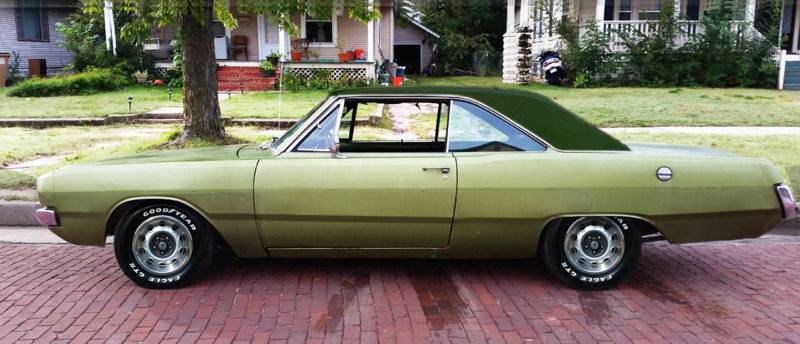

First "full" weekend to start working on the Dart. I got up early Saturday morning and headed to the parts store to get a starter. Got back home and drove it 6 blocks to the carwash to clean up the greasy parts and scrub off the oxidized paint. As I pulled into the parking lot it coughed and died, I coasted into the bay and got everything all cleaned up.
Before her bath:
I went to leave and it would start but not run. I had parked it right after the cannonball run home with it. So I figured I was out of gas. I put a gallon in and tried again. I could prime it and it would start but not run. Finally ran the battery down to clicks. I walked back home to get my truck and jumper cables.
By the time I got back and jumped it, it ram and drove. Cool. Got home, parked the dart, jumped on a bicycle and went back to get my truck. Got back home and the battery was dead. By this time it was getting late and I had to be back to work at 5:30. So I decided to just polish it up to see what it looked like. It will be awhile before she gets paint.
It looked better, actually it looked worse in some places because it made the mismatched panel painted section more noticeable. I got it started again and went over to the church parking lot to snap some glamour shots. After the photo session it wouldn't run again. I needed to get cleaned up for work so I pushed it into a parking space and went to work.
After a bath and poilish:

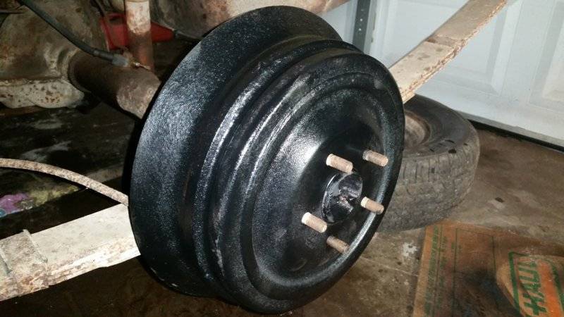

The next project for the weekend was to overhaul the brakes. While sitting at the car wash contemplating life in general I stepped on the brake with the door open. I heard a hiss. I could see brake fluid dripping from the left side of the axle. "Yay! Now I know where the leak is!" I exclaimed to no one in particular. So I started on the left side, hoping for a leaky wheel cylinder, which I had a replacement for. Alas it was not a leaky wheel cylinder, twas the axle line from the brass splitter thingy. Not only that, but the right side had already been cut and crimped lol. The good thing about a ruined braked line is it makes it easier, well possible to get a 6 point socket on the fittings! I went ahead and checked the brakes and BAM! nice pedal good front brakes.
I went ahead and changed the rear brakes and wheel cylinders and new hardware. While I was there I decided that I just couldn't leave the drums all rusty. Out came the grinder with a wire wheel and rust convertor again, 30 minutes, a bloody knee, and ripped pants later, a much better looking, somewhat shiny black brake drum. The right side went about the same, except substitute 30 minutes looking for the shoe adjuster pin for the bloody knee. Spoiler alert, it was under the grinder handle. After the first side was done I realized I hadn't paid attention to which side I put the primary shoe on. I got lucky though. 50/50 chance.
That was it for this weekend, next weekend I'm out of town for my mom's 70th birthday party so not much updating for a couple of weeks. I ordered a full brake line set from InlineTube. Wish me luck!
She looks great!
