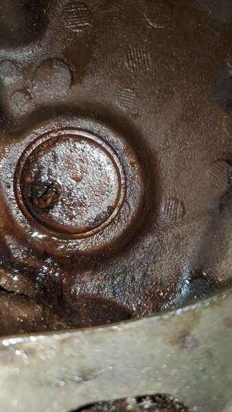

Well the first minor major work is going to be happening soon.
Since we moved in December of 2020 the Dart has been shopless so no real work has been done except some minor fiddling with the idle screws. It's been my daily driver for the last year. I don't drive much but going for groceries or Taco Bell is always a pleasure n the Dart.
I went to leave to air up my mom's tires across town and after about half a mile I noticed that the heater wasn't getting warm. We had had about 3 days of single digit and below weather prior to Christmas. After a bit the temp gauge started climbing.
I really thought my antifreeze mix was good and was less than 3 years old. At first I thought it was coming out of my lower radiator hose, but I changed it and when I filled the coolant back up, it eventually started pouring out of the transmission.
So best case scenario I get to pull the transmission and replace a freeze plug.

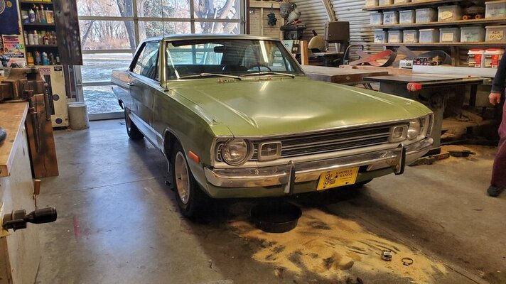

My BIL said I could leave it in his shop for awhile and I'm hoping to get the work done on Saturday.

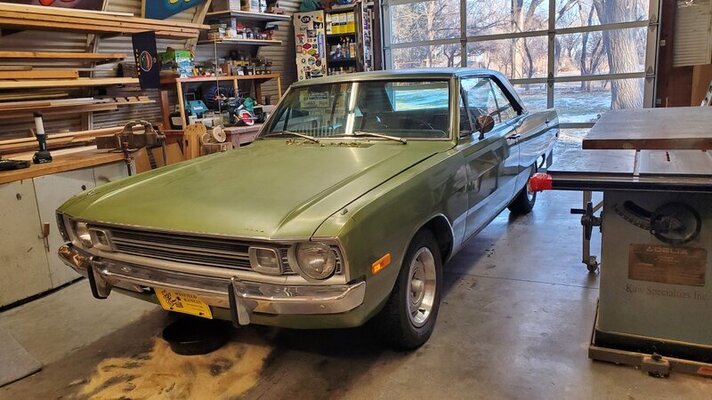

Meanwhile here are some photos of the Dart enjoying the great indoors!

We'll see this weekend when I get the transmission out. The amount coming out seems like a pop-out situation. Could still be a coincidental rusted one.

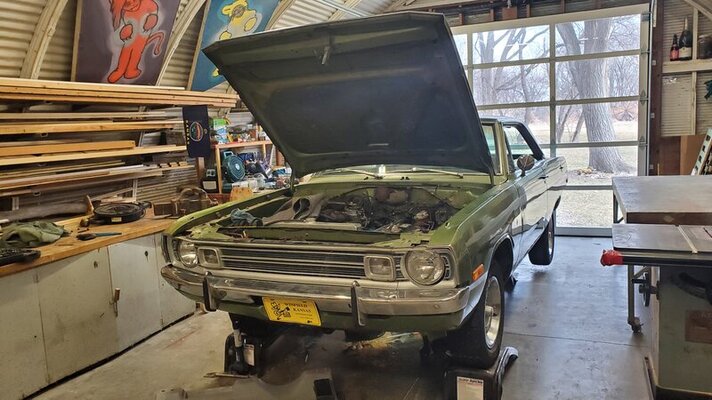

Well today was the day. Of not much progress.
Started a little after 9 am and had the transmission loose and slid back by a little after noon. I managed to do it without taking the exhaust down. I may have to loosen the driver side to get everything reinstalled though.

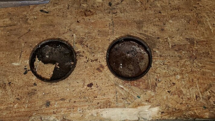

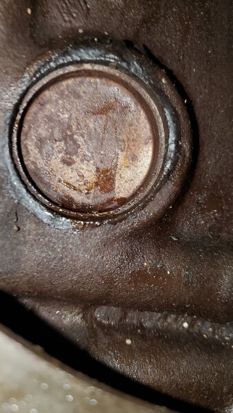

It was a rusted plug causing the coolant leak as expected. The passenger side one looked good but I removed it as well. The water channel was packed with rusty debris so I flushed a couple of gallons through the block to get some of it out.
Then the fun started. I hadn't preordered the plugs, thinking they would be readily available. I went to every parts store in town, Oreilly, AZ, Advance, and NAPA. I looked up part numbers on rock auto and they were not right. Nobody had any 1 5/8" plugs, brass or otherwise.
Finally gave up and cleaned up my brother-in-laws shop and went home about 4. I ordered a set from O'Reilly in brass that will be here Monday. I also ordered 2 of the rubber expansion style just in case.
