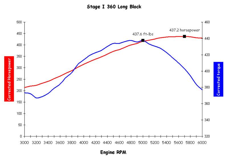

#11---360 Dyno Test (Feb 2000)
It's just too bad they stopped the test at 6000, cuz if you extrapolate the torque line down to 6600 or 6800, and convert what you find to horsepower, it is amazing how high this HE3038 cam (same as what I got, but with OOTB Eddelbrock heads), is willing to rev to.
And check out the torque curve; over 400 ftlbs from ~3800 to ~5700, 400/438=91.5%; simply amazing.
