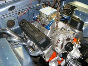

Pettyblue, very nice! What kinda' headers you got there with what size primaries? PITA to install? I am going 408 and need bigger primaries than the dougs 1-5/8
They are Hedman Huslers part #75110-66,1 7/8 primaries.Yes they are a bit of a PITA to install,but was ready for it after advise from few members.Alot of cutting/fitting for the headers also had to notch my K-member for clearance with the Mildoon pan.I had first got the Dougs through Summit(too small)sent them back and got these.I got the coated ones to keep the heat down.They were pricey,but planned on only buying once.:cheers:
