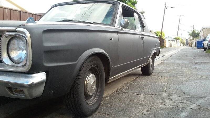

I had a stock 65 B body 8 3/4 under my 66 Dodge Dart just moved perches couldn’t even tell with stock rims. With a new rim with some backspace would of been cool to fit a 15x7 245 60 tire.
