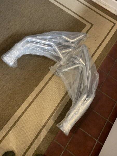

My 4 speed 340 Demon is about to wake up a bit.
These just arrived today. Almost too pretty to put on the car!:usflag:
Mine fit like a glove - 360/904. It will be interesting to see how they fit your 4 speed.

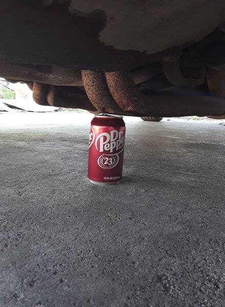

Are these like the TTI headers or do they hang low like the hookers?
They ....I’m not sure to be honest.
I’m installing a new cam on Saturday- once broken in then installing. I will know better then. Since Doug’s are a very good brand, I will assume they sit higher up.
Most any header is good except the old design where 3 tubes go under the steering linkage.
