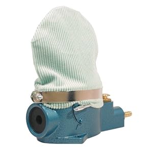

Do these really work? I dont see how they would not make a spark plug like new as long as you regap it. I know its uber scrooge like to clean spark plugs but it just seems that a spark plug only gets dirty, knowing a little about the conductive property of metal. If the electrode is not melted off or eaten up, it should bring them back to life right? Talking copper here, not IR or platinum stuff. Looks like an abrasive blaster in a bag. Blast them and then hit them with air. I just spent $2.50 a plug on my truck. I can imagine doing a fleet of vans or something...$$

I've had one of those plug cleaner for going on 20+ years. they work real good but you do have to have a large sewing needle to get the few grains of grit out.
Here is mine
X2... If you've ever looked down into a plug around the insulator after you cleaned one you'll see some grit is left no matter how much you blow it out or wash it out with cleaner. Only way I've ever got it out is like Bob said with a large sewing needle
Used a free standing unit on cars and airplanes from the mid 60's to the late 70's. It also had a tester as part of it. As has been said, got to clean all the grit out. Never had any trouble even with the plugs on A-26 Invaders.
