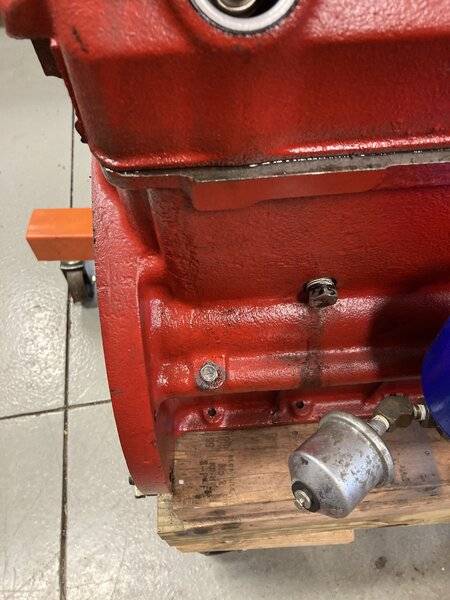

Photo of the passenger side rear side of the OE ‘68 slant block. The boss on the oil line was present. I drilled and tapped it for a manual oil pressure gauge. As the motor is out of the car I have a plug in the threaded hole.

shoot us a pic of that sender location. I've read you had it back there, was it tapped or stock? Back in the age of penny pinching I wonder what the logic was with another machining step in the block process. They even had remote trans filters back then so anything is possible I suppose.

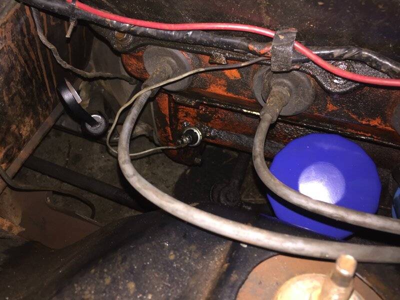

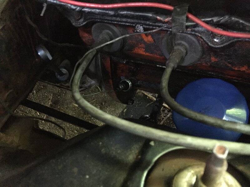

That’s little knob with the wire coming out in the center of the photo Is the sending unit? That’s the passenger side of the engine toward the firewall (ignore my dirty engine and engine bay, had a radiator line blow whole driving around when I asked your advice about coolant)

Yes, that is the sender location for the electric oil pressure gauge. Remember you are working to diagnose a problem, you can install the mechanical oil pressure gauge with a temporary line routing. You need good connections, mount the gauge with quick ties to the driver side windshield wiper and route the plastic line through a gap in the hood to cowl,,, and have info to determine if you have an oil pressure problem. Figure out running a secondary variable gauge later.
