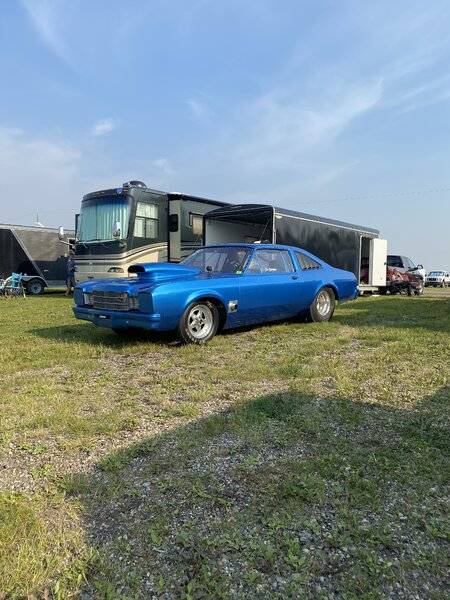

Those are a couple of older pictures. It now has full tube chassis strut front 4 link rear. Drive train is BBM 572 440-1 heads A&A torqueflight 4.30 fab9 rear tunnel ram 2 1000 cfm C&S carbs. Currently runs 5.40 in the1/8th at 127mph. Before trans improvements went 8.65 at 159 in 1/4. should run 8.50's at over 160 with the improvements. No secrets just ask.

nice car, hauling ***!
nhra say 3 inches off the ground if your can wheelis better have bars.lower does has a advantage
no wheelie bars, going to try without first.
