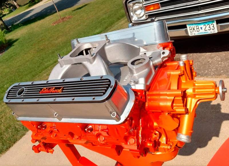

Good to hear, as I am at the tail-end of a similar build. Would love to know more details about your combo. Can't wait to get mined fired up. I only have J heads for now (mild porting, 2.02 intake), but a great bottom end.
Good looking engine Hemi orange oh yea .
I cant wait to get mine together
