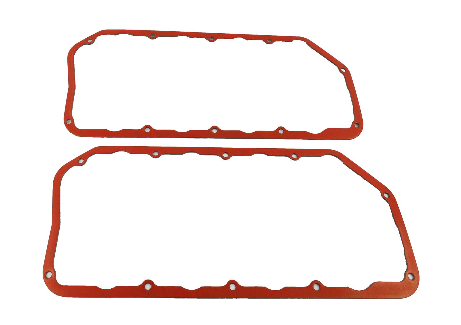

Looking at getting new valve cover gaskets, I don't want to go through all this and then find I have a leak. What is the best thing to use to attach the gasket to the valve cover?
do you have stamped valve covers or cast alum? and alum heads i assume?
if it's both machine surfaces get blue silicone gaskets.. you can take them on and off all you want and they don't leak.. i use moroso but it doesn't look like they have hemi ones
Those have a steel core and rubber/teflon outer... good stuffs.. just make sure they are the right ones.. hemi stuff is weird
P.S. with 2 machined surfaces and those gaskets you shouldn't need any sealer/glue

? you use bolts.... lay them on the head.. put the valve cover on and line up the holes... in your situation i would honestly be using like 1.5" long studs for the valve covers.. then you just lay the gasket on put on the cover and then nuts
All good with the bolts, did not know if there was any additional sealant.
Already have these that came with the covers from Ray Barton :thumbsup:
ah.. then nope... you could glue the gaskes to the valve covers but no reason to.. machined surface to machined surface seals really well... old heads that were cast iron had a sealing surface like the moon.. just craters and nasty, thats why you use cork with them
