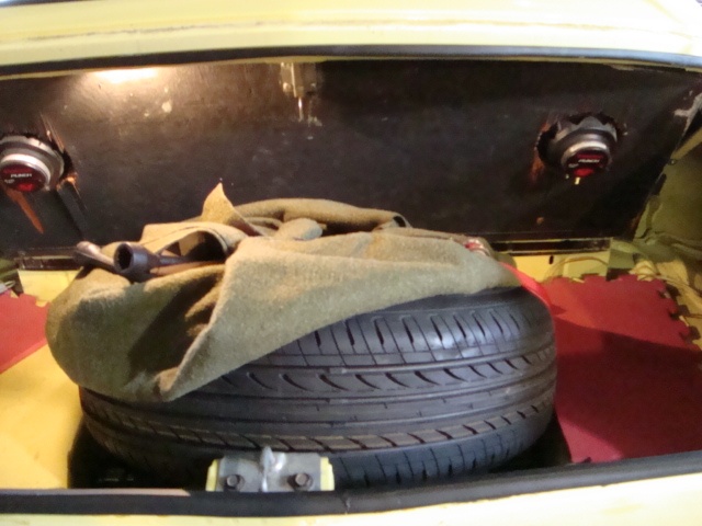

OK, I took a whole bunch of pics but first I'll show the factory gasket on the body with pics of the holes that are in the front of the trunk lid.
Treblig
Now some pics of the inside of the trunk and the open areas in the back of the car as well as the hinged panel that all fastback Barracudas came with. If you look closely you can see the plugged holes from the inside of the trunk.
Treblig
Last pics of the gap between the trunk lid and the body. The gap looks pretty good so I didn't want to mess it up. That's why I went with the extra gasket on the lid.
I appreciate all the help and all the comments. Like said before, I am considering covering the large holes on the inside of the lid so I can leave the small holes open. But (now) I am also planning on undercoating the inside of the lid because I live in one of the worst environments for corrosion in the US.

The holes on the front underside corners or the deck lid came from factory with body plugs. I also notice you have a couple of plugs missing in the truck floor pan that also need to be installed

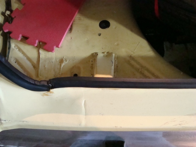

What is the ruff looking spot on the left bottom of the picture? Did you have to piece the gasket or something.
Xs 2! I would venture to guess that the missing trunk floor plugs are your biggest culprit. Tape over them and road test it again.

The lower part of the trunk gasket is not in the right location,should be on the lower flat part in front of the 90 deg. lip here's a pic of the correct location
The gasket in this pic looks totally different from mine. Also my gasket has a groove in it that seems to fit onto the lip that goes around the bottom of the trunk (it was installed basically by pushing it onto the lip from the top side). I got the car like this so I assumed it was correct but the one in your pic actually looks fatter (more bulky). Could I have the wrong gasket or is it installed wrong??/
attachment.php
OKC, the rough looking spot is where the two ends of the gasket butt against each other. Also, whoever installed the gasket used some sealer or silicone to mate them together. I really have no idea if the correct gasket was used. Wish I had a better pic of a correct gasket (close up and cross sectional view). thanks for the input!!

Looks like a second seam here. This gasket just doesn't look right for the car to me.

Yes, there is more than one seam (break) in the gasket. I do not know if it is the correct one and I don't know if it is installed correctly. Is there a website that shows the correct gasket and installation. Thanks, Treblig
That is a pieced together generic gasket that isn't made for the car and the correct gasket only has one seam. The single seam should center the trunk latch.
I did a little research and found a seal just like mine at jimsautoparts website, P/N WS-323. Is says order by year, make and model. It looks exactly like the one on my Cuda. Is the one shown in these pics the incorrect one??? Where do I get the correct one??? Or is mine just installed wrong.

Thanks, and yes it does look like mine and yes I do believe mine is installed incorrectly. I did some more searching and found these great pics that show where everything went wrong BUT there's still a problem. I'll explain in a minute. When I first started this thread it was about the two small holes in the bottom of the trunk lid. Had I known my gasket was messed up I would have done some research before starting the thread. The problem I mentioned is that I will still have a exhaust leak problem even if I install the gasket like the pics on this post. When I was inside my "closed" trunk with my friend shining a light from the outside I saw light coming from the area where the weather strip runs vertical on either side (looking at it from the rear). So if I correct the seal on the bottom lip I will probably still have air leaks on the sides. Of course I won't know for sure until I actually do it.

For those who might be interested here are the pics of trunk seal installation from "The Bible" ('69 service manual). This is for Valiant and Barracuda, the seal looks nothing like the one I have and yes mine is installed wrong on the lower section.
Treblig
This is the correct gasket for 67-9 barracuda. The one in the car is not only incorrect but is not placed correctly to boot. The factory gasket is one piece and starts and ends 4-5" to the right side of the latch.
