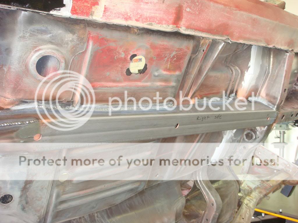

while bolt in connectors are a good first step nothing beats a good pair of weld in connectors. US Car Tool makes weld in connectors that look like they were put in by the factory. I will be using on my notchback in a few weeks. here is they link

Us Car Tool Looks like they belong:
hard to get them that nice doing it from underneath laying on your back

I am in the process of installing the US Car Tool connectors. Taking out the seats and carpet wasn’t the hard part.
