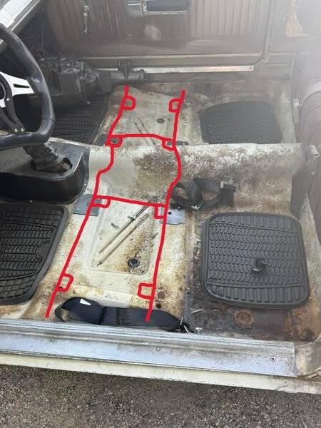

I have a 67 Valiant, I will soon be welding in 1.5" dom tubing to mount my bucket seats to.
Basic plan is 2 tubes going from drivers side, bending over the trans tunnel to passenger side with 4 cross tubes between those and tabs to bolt the seats to.
What I am contemplating is how to mount the tubes.
Option 1) Flat steel welded to the sheet metal/factory steel reinforcement the stock seats originally bolted to.
Option 2) Depending on tube steel subframe connector possibilities, if I can reasonably make subframe connectors with tube steel, I may do that and tie the seat tubes to the subframe connectors.
Will any of you that have custom subframe connectors (aka cage work) related to what I am describing, I would appreciate it :)
(pic is a loose idea of what I want to do inside, definitely not dimensionally correct)

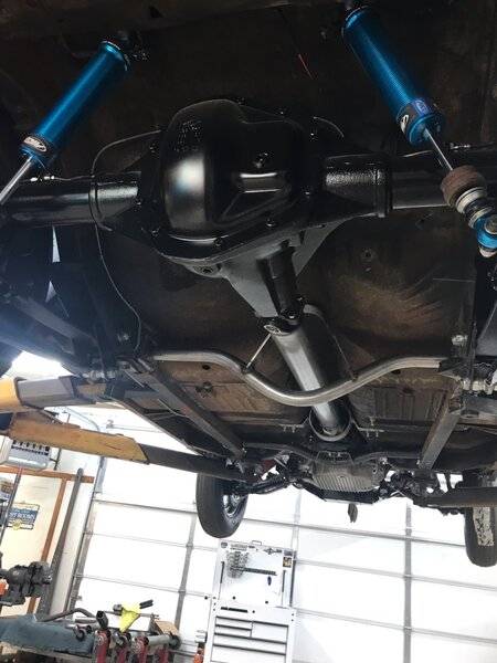

Here is how I did mine:
20240909_170721-jpg.1716306151
20240918_165612-jpg.1716306154
20240918_165437-jpg.1716306152

So much looks familiar in those pictures! I did my subframe connectors the exact same way and of course, the wheel cribs as well.
The cribbing split into two parts is all your idea, you get all the credit for that.

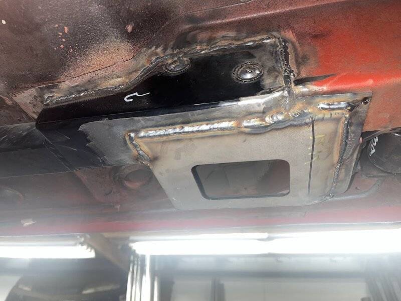

The original plates aren't any more than 1/8", and the floor panel has a depression in it for them. When run in the standard fashion from the rear frame rail/spring mount to the torsion bar crossmember the subframe connectors fall closer to the outside mounts. This is the inside view showing where the US Cartool connectors welded to the floor.

I should have been more clear, What I was wanting to see was others subframe connectors to see how they looked. So I could see about maybe tying my seat tubes to the connectors, later probably adding a 6 pt cage too.
If you're looking to tie those seat supports into them, you may want to think about running 2x3 subframe connectors with the 3" side vertical.
