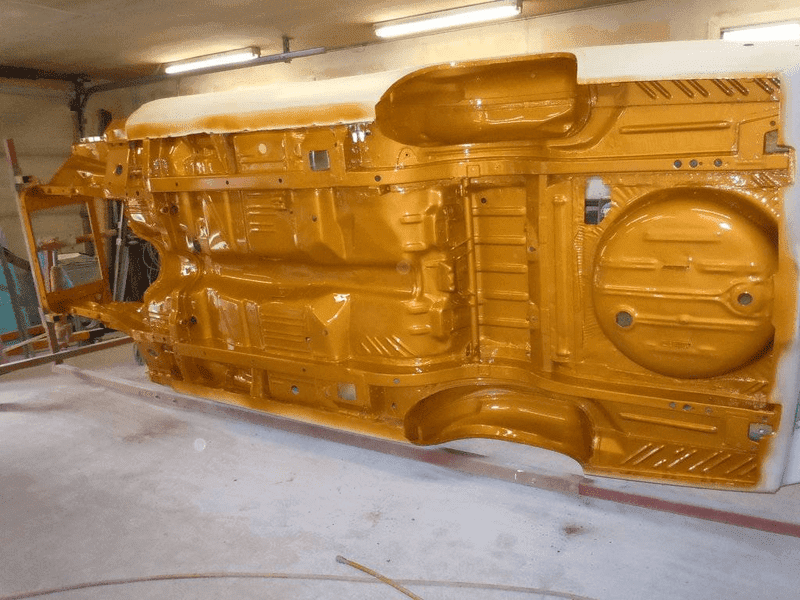

otherwise, the US Car Tool connectors are really nice but way more work to weld in since they form a boxed connector by using the floor as part of the box. If done well, they can "look factory"

US car tool connectors. Not my car (I wish) The bottom photo has the Torque Boxes as well.

After rereading the op post, us car tools sfc's after you do the floors, fresh metal will be nice to weld on.
