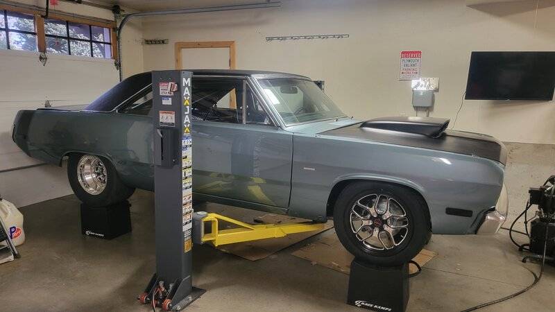

Here's when I did mine. Race Ramp blocks so I had room to work, and the post lift held the connectors in place so I could weld everything
Perfect! I have the same set of raceramps, and the older version of the maxjax, never thought of lifting it that way.
Show-off!:poke: But I caint imagine any way of doing it that would be more correct than that. Man, I've got to upgrade my work environment...
