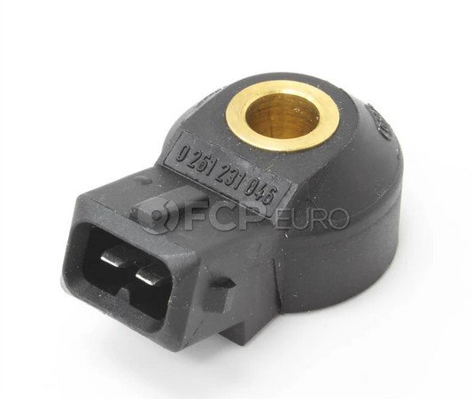

Pic of the particular sensor You are using???
There isn't a great one, but theoretically on the cylinder head or threaded into the side of the block under the exhaust would be best.
But don't go into aftermarket knock sensing with high expectations. OEMs blow up a half dozen engines on the dyno while using five figure amounts of instrumentation to get the level of knock sensor tuning they have.
Something like this.

OK, that's like a Subey one,....flat/flush mount & a screw. Valvetrain & exhaust noise can both trigger false knock sigs., hard to avoid both,.....You could just drill the block anywhere mid-high & spot-face it, then tap it. As long as You're clear of exh. pipes & excess heat, it should function fine. Mopar's 2.2/2.5's put them on top of the intake plenum, but a cracked EGR pipe was setting off the one on My lightly modded turboI, I ran it for years w/o the sensor hooked up until I found a good pipe & time to swap it in.

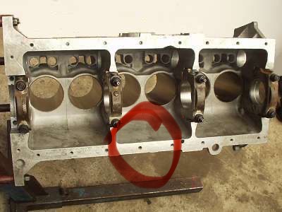

Thanks guys. The guy I bought my Haltech ECU can do all the tuning. He does this full time. His recommendation was right below the head in the middle of the blick. I think I found a web inside of the block that is wide enough and thick enough to drill and tap for a small bolt.

...and mere INCHES away from the threaded boss in the cylinder head. Drill your hole. Have fun!

You’re not a retard stop it. But if you’ve never tuned an aftermarket ECU to the necessary threshold for false knock vs real knock and experienced the frustration that can come from it you should just watch. Sticking the knock sensor in a location susceptible to a bunch of other frequencies lessens the chance of actually being able to use it for its intended purpose. It WILL pick up any and every harmonic and frequency that is being produced, the sensor is stupid, it’s the ECUs job (specifically the range of frequencies that the tuner tells the ecu to look for) to filter out what not to look for as well as what to look for. And it gets exponentially harder to tune the more false crap the sensor pick up.
