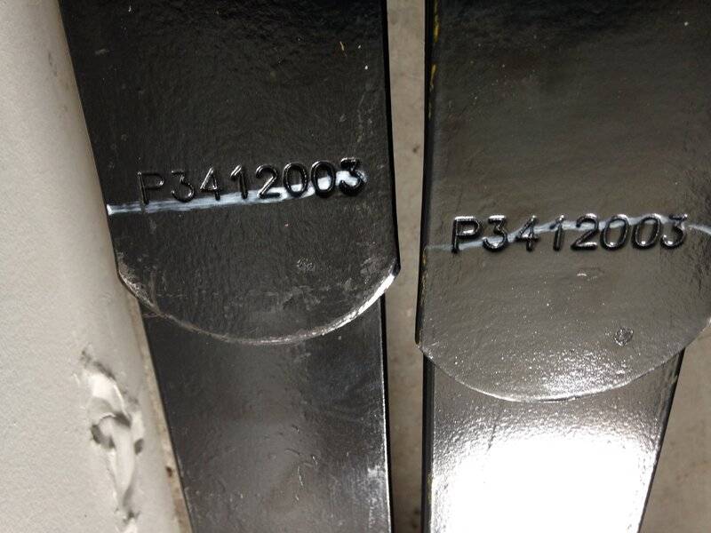

the 002-003 springs that were made in America, before being made in mexico, always set higher on the pass side. they were built for putting more pressure on the pass side tire . you put the mexico springs on a high h.p. big tire a body that really hooks up, and the pass side springs are bad about bending the top leaf. I`ve got a set of them that came off of one of Jim Hales barracudas.My 002 and 003 springs sit level as well. They don't have a lot of miles on them so that may change but for now they are level.

you guys that are running two drivers side springs (003) , do they hook up well at the dragstrip ?
