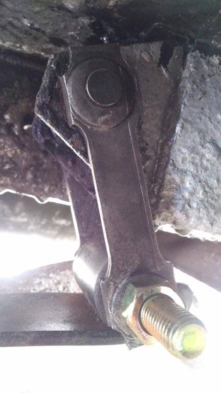

Could you take clearer pictures of the rear again as well as the front spring hanger?
Here's a couple pictures. Just tried the crowd bar and loosening and retorqing with full weight on and nothing. Same thing. Bolts are in shackles because the SS springs needed larger bushings. Could it be because I'm using the 7.25 rear end?

The angle of the shackles is correct in direction. But I do see there touching the bracket. How hard is it resting on the bracket?

Those bolt heads look.... Unhealthy....

Front hangers are flush to the steel frame and torqued tight.
The driver shackle is just about to touch, passenger is touching a little.
