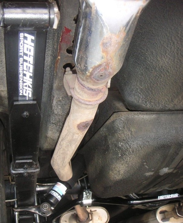

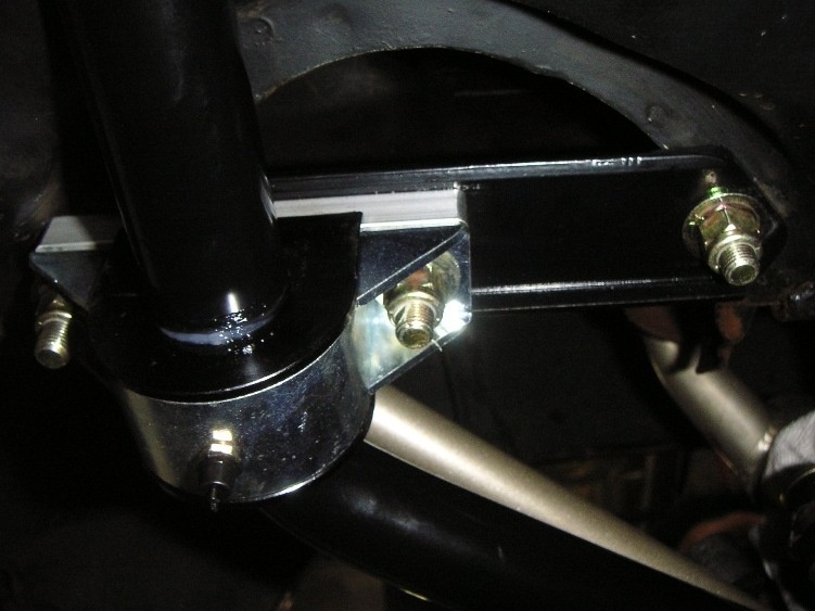

The Hotckis sway bars are hollow at save about 7 lbs up front and about 1 lbs in the rear. The front has a nice stamped cup to accept the bushing and the ends are rounded tightly so as not to clip or interfere with the lower control arm. Sometimes that is close. Also the attaching hardware is stout as hell and nice precision stuff. The Addco bushing retainer is just one stamped piece with universal bolt slots that end up sliding back no matter how you installed them.
attachment.php

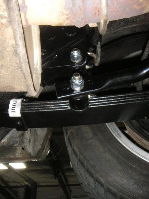

The Hotckis rear is hollow also and it's adjustable. This allows you to fine tune your car. There is no way any kit is going to be a perfect neutral handling car for every application. Everybody's car is a little different.
attachment.php
attachment.php

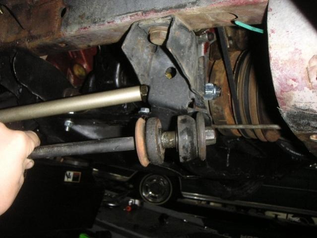

Hotchkis upper control arms, strut rods, and tie rods with precision rod rods. Tie rod sleeves are lightweight thick wall aluminum. My front end doesn't "snap" like it sometimes did with the poly strut bushing.
attachment.php

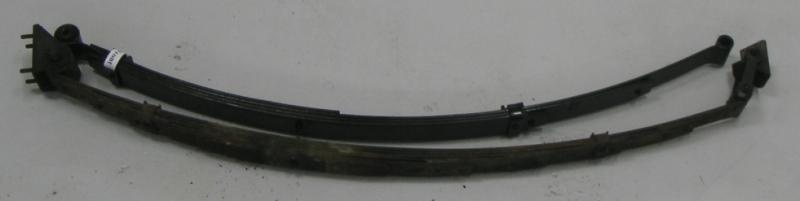

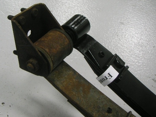

The rear leaf springs are pretty unique. The ones you get from PST, Just Suspension, Spring and Things, Detroit Spring, XHD Mopar, are not like this. The Hotchkis leafs have two really thick under leafs that extend all the way to the front eye to prevent spring wrap up and then another thick leaf on top to prevent wheel hop under braking.
attachment.php
attachment.php
attachment.php
