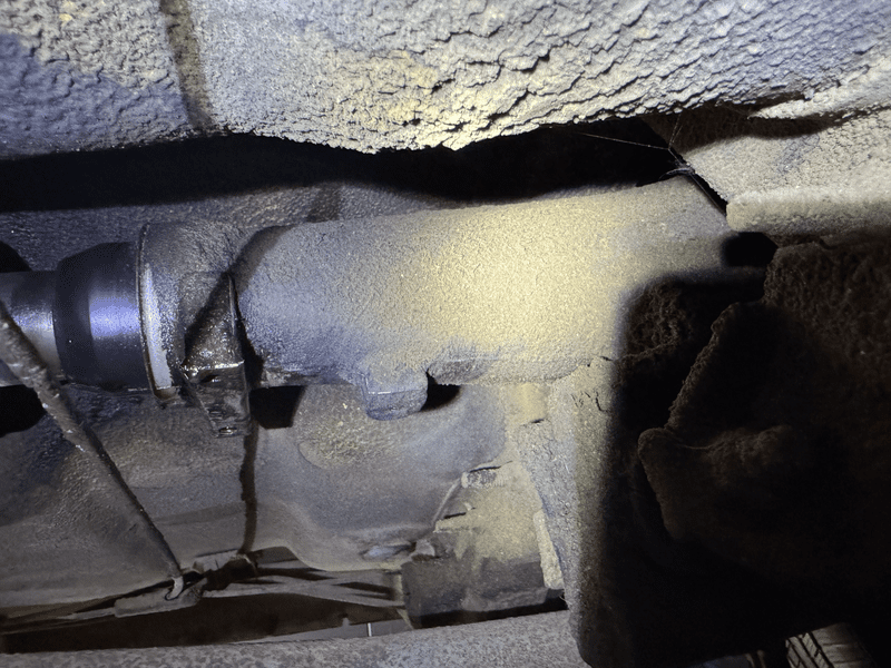

Edit: After a closer look, it seems the trans fluid is coming through the tail shaft seal and dripping down. My understanding is that the tail shaft seal is really just a dust cover to keep dirt from going in, not meant to seal fluid. So if that's the case, what would cause this type of leak?
I've got several transmission fluid leaks on my '74 Plymouth Scamp, /6 auto - and after cleaning things up, it appears one of them is the extension housing snap ring cover gasket. I'm having a heck of a time trying to find a part number or even the correct name for it. Does anyone know if this gasket is available? A part number or source for it would be amazing. Or do I need to make my own gasket for this?

Original post updated, title edited, new pics added in original post. Trans fluid is coming through the tail shaft seal and dripping down. My understanding is that the tail shaft seal is really just a dust cover to keep dirt from going in, not meant to seal fluid. So if that's the case, what would cause this leak?

There is a lip seal on the inside that seals against the slip yoke to keep the fluid inside. The outer part is the dust boot.
There should be a drain hole in that boot at the bottom to keep from trapping water. Looks like yours might be there but can't tell if it's installed right side up. I poked a hole in mine
Definitely no holes in mine. It came out pretty easily. The outside rubber is cracking, so I'm guessing the inside wasn't sealing so well. Ordering a new one now.

Probably either over-filled, or more likely is that the the converter anti-drainback valve quit working, and so, now, when you park the vehicle, the convertor drains back into the trans, raising the fluid level up to the rear seal. Normally, there is very little oil at that rear seal. Normally, with engine running in Neutral, the oil-pan is barely full,
The outside boot you see is indeed a rubber dust boot. However, there is a conventional seal made to that that presses into the rear of the transmission tail shaft housing. The rubber boot on the outside seals the outside of the slip yoke from dust and dirt entering into the main seal area and possibly damaging the main seal that seals the yoke and keeps the fluid inside the transmission. Not all those tail shaft seals have the boot, but I prefer them. Kinda gives another layer of protection.
