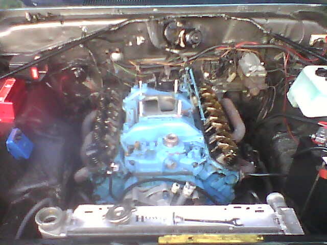

Well I am tearing down my engine to install a new Camshaft and lifters and Timing Chain and Gears. Cam is a Comp Cam Camshaft, Hydraulic Flat Tappet, Advertised Duration 272/272, Lift .454/.454, Matching Hydraulic lifters, Timing Chain is a double roller Crane Cam Model 69993-1 I have a couple questions-- If I install this setup I have a set of Mopar 360 heads part # 4343475. Heads are stock and have never been machined as far as I can tell. Would I need to change out anything if I decided to use these heads? I will be running an Edelbrock Performer manifold and an Edelbrock 600 CFM Carb, Hooker Comp Headers, Transmission is TCI Streetfighter with a TPI Converter 2500 stall. Would I need to have these heads machined to keep up the compression ratio? And if so, would I need to change out the stock pushrods? Would changing out the stock rockers for roller rockers make a difference? Any help is appreciated in this as I am kind of new at this and am trying to get a decent setup that will be a strong low end torque motor. Would advancing the cam also give me more bang? I posted a couple pics of the teardown as of now. Sorry these are cell phone pics. My camera is DOA.

Block is stamped 340. cannot see the stamping with the headers on very clearly. Tore deeper into it last night and have already been outside at it this morning. Here's a few shots of old parts removed. Oil galleries and intake look to be very clean upon teardown, :hello1: Going to be removing headers and cylinder heads today. Then I am thinking of stripping the engine bay of the paint thats there and removing all the components in the engine bay and covering the block and strip and paint the correct color. Just need to check if I have enough paint stored away to shoot engine compartment.
Are you sure about the 340 stamping? This block has got the threads to put the retainer for the roller lifters in the valley, so i think it´s a late roller cam LA 318 or 360 - as far as i know there was no 340 made with this mods.

Good eye. 340's never had roller lifters and those are definitely roller lifter spider bosses. Must be a 87 or newer.

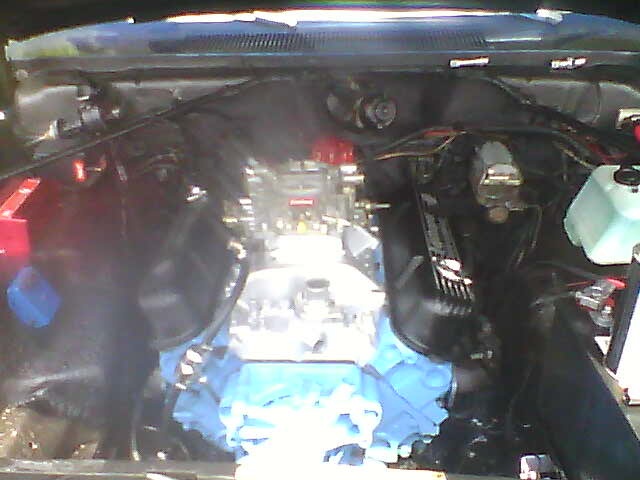

Great weekend to put the engine back together!!! With the 100 degree heat and the sunshine it will be a scorcher but I have already been at it since 7:30 A.M. Hopefully I will have her up and running by the 4th!!!!!!
If you look on the block directly under the driver side head there should be some numbers. The first set should be ci's. If you look at the pic you can see it here.
