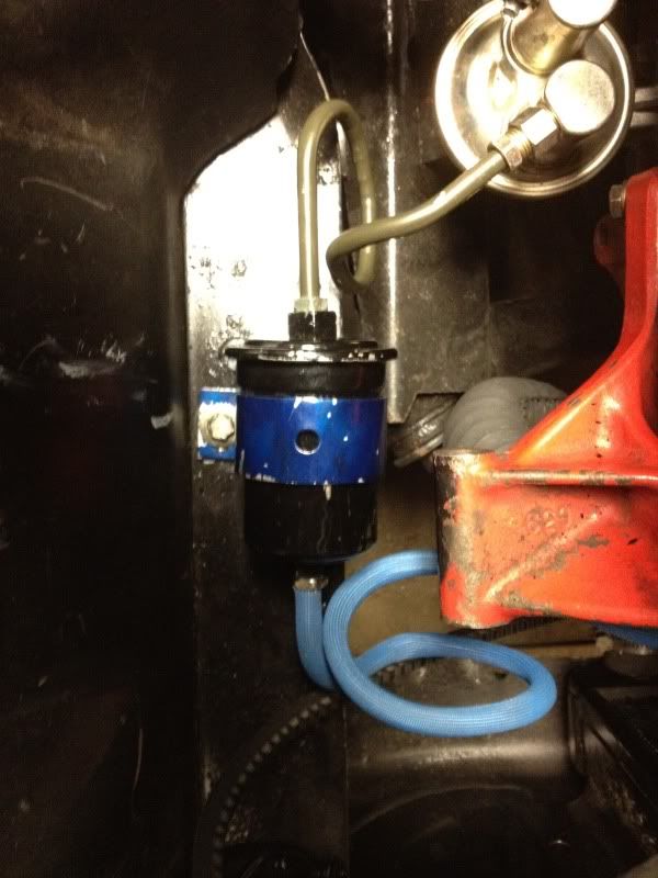

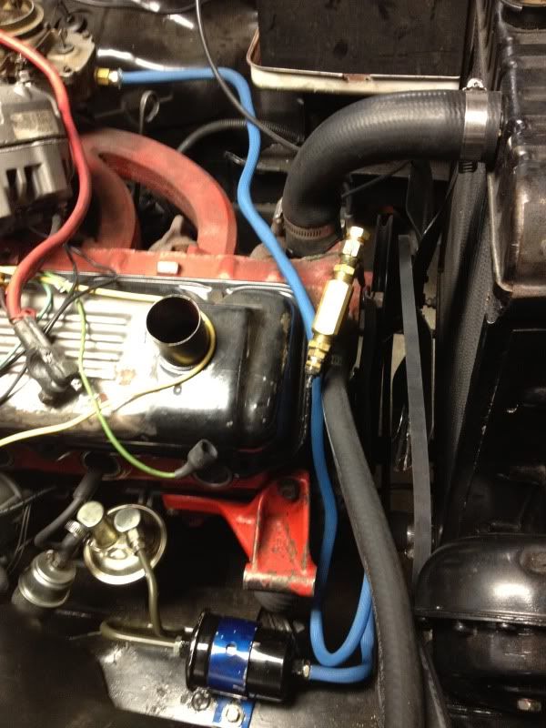

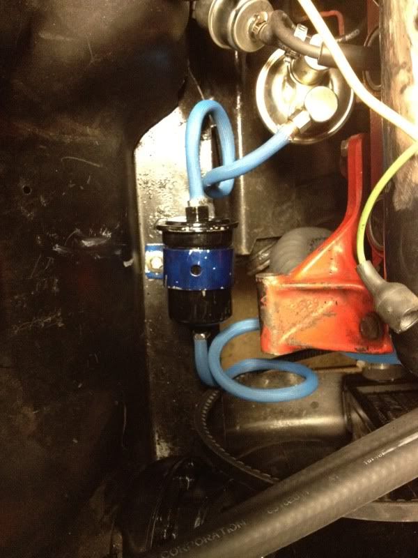

I think your goal of eliminating all rubber in the fuel plumbing is smart. Let us know if you find something that works. Even scarier are some EFI aftermarket kits like the Holley Pro-jection I put in decades ago. Ships with an EFI filter w/ quick-connect fittings and just rubber hose and clamps. Never leaked, but I was always scared of the hose popping off w/ 20 psi.

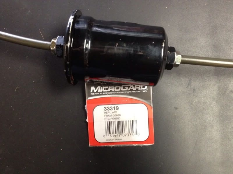

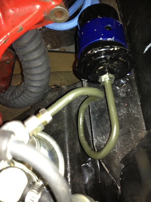

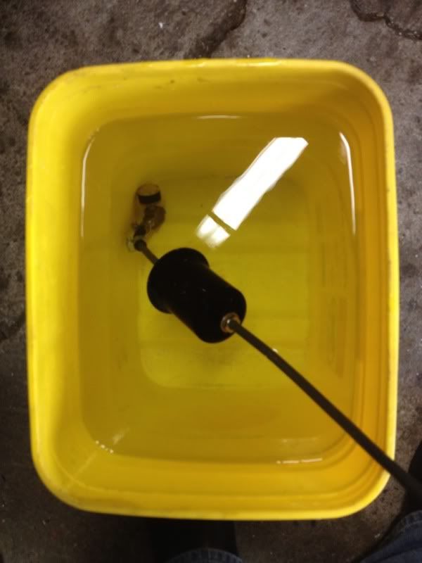

Well after my failed attempt at trying to hand machine fittings to except an O-ring, I managed to only get one fitting that sealed the other one leaked this left me going back to the drawing board and rethinking the whole filter assembly. I went back to the catalogs to see if there were any in-line filters that we're not fuel injection style, the only one that I discovered that was inverted flare was one that fits Toyotas and Hundyias. *The only problem with the filter is it only excepts a M 14 X1 .5 mm fitting, but is still inverted flare. The store I work at did not carry the fittings I discovered that AutoZone and advanced auto under the AGS brand carries the tube nuts that excepts the 5/16 fuel line. *The two tube nuts had to be modified slightly with a file in order for them to seat properly in the filter. I then made two test lines with a air gauge on one end and a air control valve on the other end. I tested the filter at 10 to 12 psi as the fuel pump is only pushing 7 psi at the most. No leaks and installed. *Car runs, now on to other problems to solve.
testing filter/fitting assembly.
Filter that I used.

One issue you might take a look at is the filter mounting itself. It's mounted on the frame and you are running hard lines to and from it. This won't allow flexibility for engine movement. It's why the factory ran a rubber hose from the frame line to the fuel pump. The movement and vibration will work harded and eventually crack the line or the filter. If you attatch the filter to the block with a bracket you should be gold.
