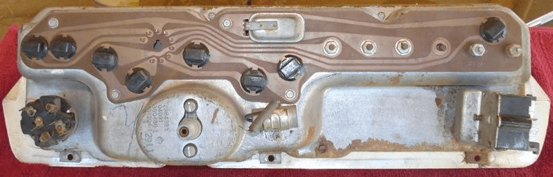

I didn't take time to solder or assemble anything - just clipped one of the pots onto a gauge pin and to ground, and twisted the knob. Both gauges went back and forth and stopped in the middle as I turned the knob. I didn't have the DVM in the circuit so I can't say what the range is, but they definitely respond to changes in resistance. I'll see about soldering the pots together and putting them in a project box tomorrow. With fewer alligator clips I will be able to get the DVM in the circuit and try to measure it more precisely.
I put it all together again on the bench - actually on a table next to the car.
I connected the pin output to one side of a 100 ohm pot and grounded the other side
I also connected my DVM into the resistor circuit.
When the cluster was powered the DVM read 1. (open), so, I would sneak up on the adjustment and watch the gauge. Once the needle got where I wanted it and stopped moving, I powered the cluster off (removed ground), and read the ohms from the DVM.

Redfish, another thing I noticed after having numerous clusters apart and refurbishing gauges ( Rallye Gauges only) is that the oil pressure gauge and the temp gauge internals and the windings look identical.
Are they the same gauge with a different face?
Yes and no. Those 2 gauges are upside tight or upside down in the rally panel. If this panel had a oil gaige it would be identical to the temp gauge less the screen.
This case, what have we not considered besides the 12 volt supply? Earlier models had more than 1 "hot in run" supply to the inst' panel. 1 to limiter, another to warning lamps, etc... 1972 or 73, whenever the larger white fuse box appeared, everything that needed 12 volts got it from the same wire and its likely fused. Is any of this relative to the issue? I don't know.
