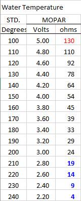

I took ohm measurements on a new sender.
The numbers in red are extrapolated from the resulting graph.
Just my opinion, but I still think you have a bad sender at 300 ohms, and they are not logarithmic.
My chart is on the sender in my car right now before I installed it
Ok not logarithmic but not linear either, I guess that means it exponential ( a curve)
as I posted above but perhaps this is easier to read
room temp 70 deg is 346 ohms and 150 deg is 74 Ohms

Here is my Mopar sensor calibration readings (see photo).
Ignore the voltage readings. They were obtained from a DC power supply rather then the factory IVR "chopper" circuit for regulation. It’s not possible to read voltage or current when using the factory type regulator.
Looks to be in align with readings others have reported. Thanks for sharing.
