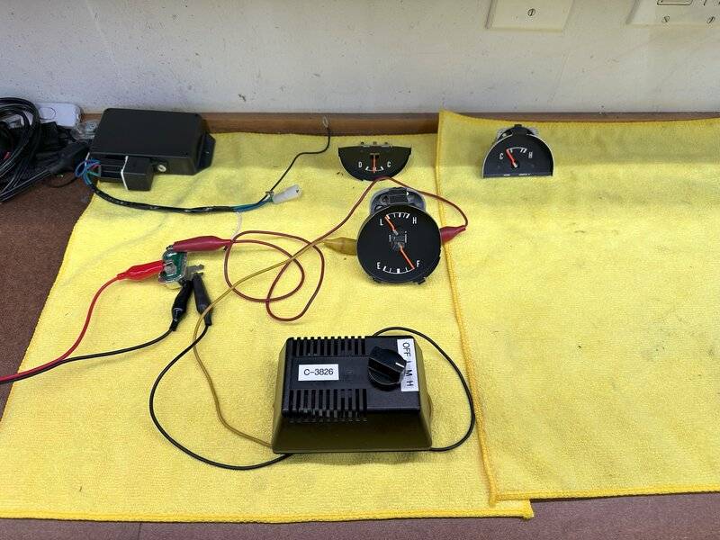

My 1973 Dart resto is now in the home stretch and I'm revisiting my temperature gauge problem. I'm using a version of the tester C-3826 that I have, where you connect one test lead to the sender terminal connector and the other test lead to a good ground. The FSM then says to turn the ignition on. My tester supplies power at different voltages to the terminal connector(3v, 4.5v, 6v, 7.5v, 9v). When I turn the tester on, the gauge needle moves the correct amount only when I leave the ignition OFF. When I turn ignition ON the gauge needle goes to zero, all the way to the left. Does this make sense? I'm confused as to why the needle drops with the key on. Does tester C-3826 supply power like mine does?
I've never heard of this. (The idea that the tester applies power??)
The only gauge testers I've seen are nothing more than switched resistors. Typically, one for the "low" point in the gauge, one for half scale, and one for the "high" point. All the gauges more or less, have the same scale. In other words, electrically, you could take a non-Ralley fuel gauge and sub it for a temp gauge and they should read the same.
Also, a "round the corner" way to sort of test gauges, would be to "lets say again," a non-ralley cluster----rig the temp and fuel gauge so they are in series, and hook to a 1 1/2V battery, and the two of them, because they are in series and identical, should both read the same.
This is not a Mopar built tester, but it works the same. The yellow print was added by the original poster, not I. It simply shows the resistances used for the 3 readings.
So far as I know, the factory testers are the same way
c-3826-jpg.1714848381

What you have there is a power supply, plain and simple. DO NOT backfeed that into the gauges
You may/ will likely blow up the gauge regulator/ limiter
If you have the cluster out/ disconnected, and if you also have the IVR pulled out, you could wire it to the gauges to see if they move, but you have no values to justify what power level causes what action at the gauge(s)
One thing you could do is to check that the gauges are equal reading as I said before. What you would do, is, with the cluster out and disconnected, and with the IVR removed, hook either power supply lead to one of the gauge sender studs. Connect the other lead to the remaining gauge sender stud. This will feed power in series through both
Select the lowest voltage setting, and let them sit for maybe 10 seconds, see what they read. If they both move, they should read the same. If they are below half scale, step the voltage up one notch, and repeat. BE CAREFUL that you do not get too much power to them. THEY DO NOT operate on 12V. The 12V feeds the IVR which outputs roughly 5V equivalent in normal operation.
. My big question remains: why does it stop working when the ignition is turned on?
Because you are supplying voltage to the pin that gets grounded by the sender AND the car is providing voltage then the pin that it normally does
Take alight bulb and apply 12v to the base and the center pin.... No light. There is no delta between the voltages.

Yes Sir, I know it's a power supply. It's been a Godsend over the years. I just figured it would help me to determine if my gauge is working, or not. I guess I did accomplish that because the needle does move up commensurate with how much voltage I supply. I do like the idea of hooking up the Power Supply to the two gauges in series to see if they move in tandem. Question: the two gauges(gas and temp) share a common segment of the printed circuit board, If I remember correctly. Is that the power side or the ground side? I've been doing my testing, wiggling, and jiggling with the IC installed. I think that ultimately I'll have to remove it because I believe my fault lies with something with the IC. My sender is good, I'm betting my gauge is good, and I've given the wiring up to the Circuit board a real good look(continuity). What's left: the IC! Funny thing, I think that gauge worked before I removed the IC to replace bulbs and clean it up last year sometime.

That's a great explanation, and that did occur to me but had I had no idea of the physics involved. Heck, I didn't even know a C-3826 tool was using resistance only, until 67dart273 told me. Can't wait to watch the video so I can be a a pro, too. Haha! Thanks.
As mentioned, the Miller C-3826 special tool (referenced in most all FSMs from the time) is a dealer used factory tool and is simply a three-way selectable resistor pack, having the resistance values I added to that cropped picture above prior to posting it some time ago on one of the forums. It does not provide any power. Miller supplied most factory special tools used at dealers then. It can be easily recreated and used to test/calibrate most any factory sweep gauges from that time.

all gauges in our cars, the ground is provided but the sending unit. The temp gauge, the oil pressure gauge, the fuel gauge. the common trace comes from the IVR (whether external like on the Darts or internal in the fuel gauge on the Barracudas) it is the 5-6 volt power for the gauge.
The IVR MUST be grounded to work . The IVR takes 12V and converts it to pulsed DC in the 5-6V range (its all in the video :poke: :poke:)
The IVR works like a blinker of sorts, it opens and closes slower or faster to provide a steady pulsed voltage for the load
the gauges have a bimetal strip with a heater coil around it when the senders resistance is low like 10 ohms the heater coil gets more current and heats the heater up and the bimetal bends more and the needle moves farther to the hot , Full end of the gauge. if the sender has high resistance 72 ohms there is less current and the heater is less hot and the bimetal bend less and the needle moves les so it stays to the empty cold end of the gauge.

Been here more or less since 2007. Hashed this over a few times. Wild needle swings are a symptom of failing mechanical limiter.
Too much juice from the limiter wouldn't effect the temp gauge with a cold water signal. The fuel gauge is drawing it at that time. That needle climbs real good. When the water is hot the temp gauge draws all that juice.
I posted and then went backreading to see if you had been told b4. I found so many typing IVR. That is instrument voltage regulator. The one we would use this application is a solid state component that can take in 9 to 35 VDC and output 4.8 to 5.4 VDC constantly. The symptom you describe comes from yesterdays mechanical voltage limiter. I can't bad mouth yesterdays technology because it did work, very well in fact, for Chrysler, Ford, VW, etc... Nothing lasts forever.
