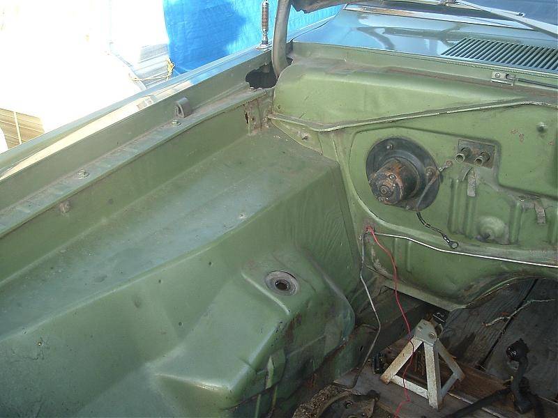

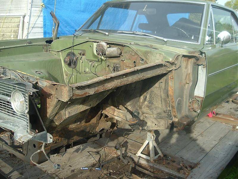

Its been a few months since I've brought it back but now I'm getting going on it again and hopefully wont stop till its drivings. I've taken a few pics of were I'm at now. I like how FlyBoy has documented everything he been up and I will try to do the same.

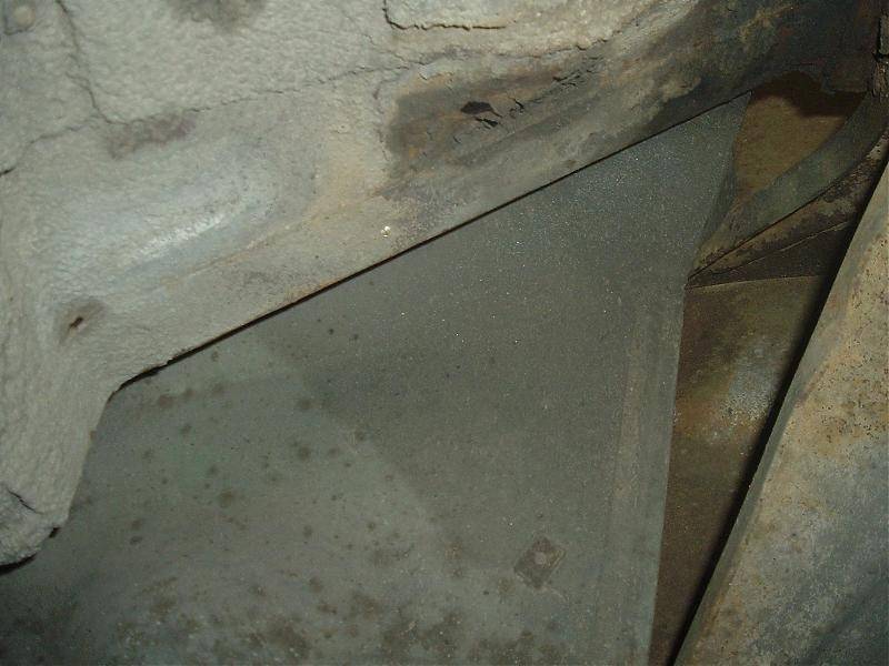

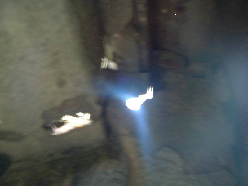

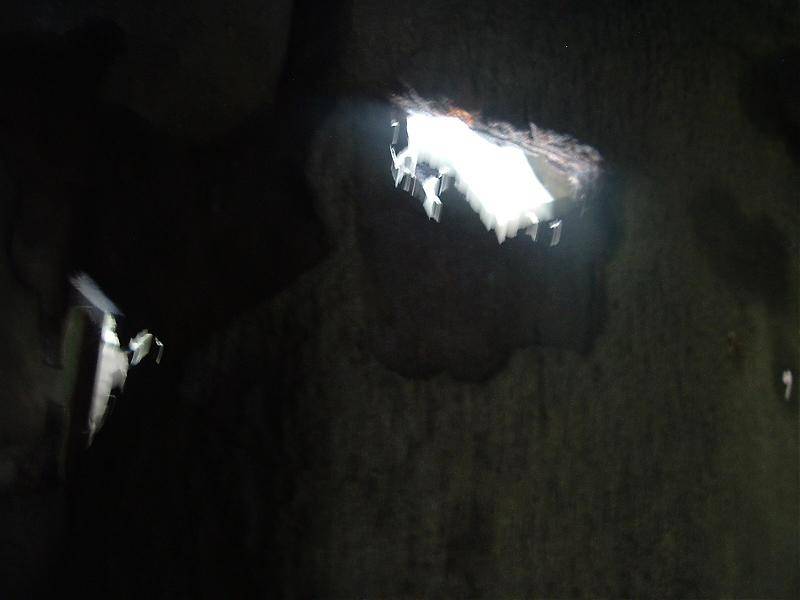

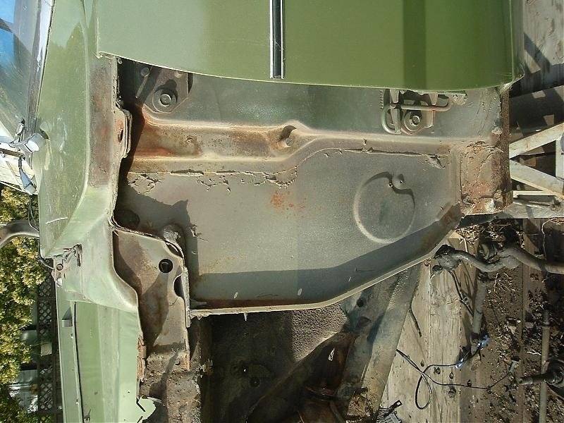

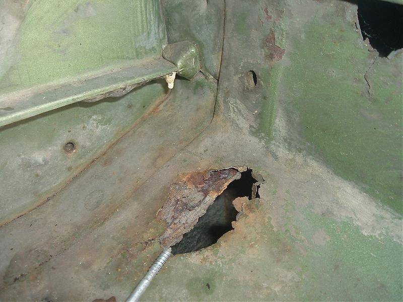

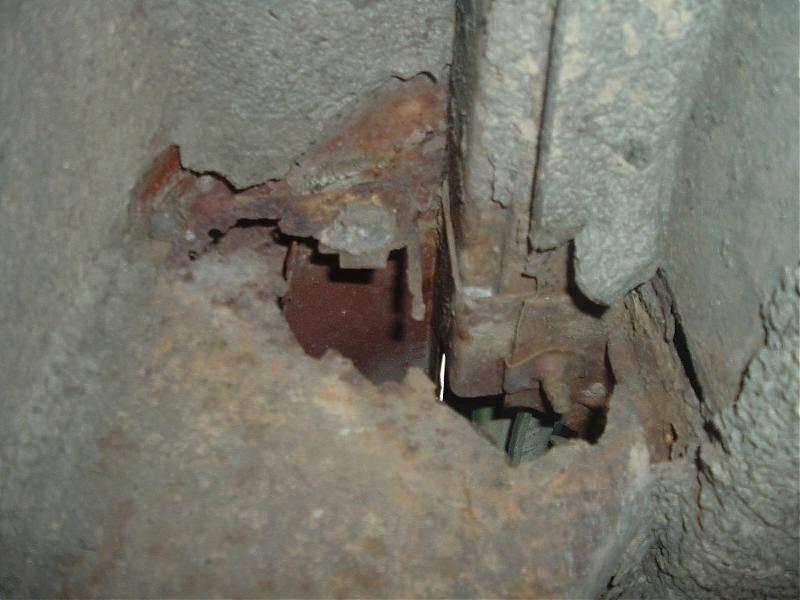

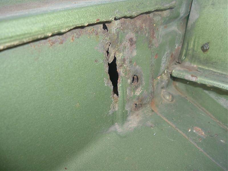

When I first picked it up I thought I really lucked out and it didn't have much or any rust.... Then i started to take stuff apart and crawl all over it and check out more hidden crevices and found this crap.

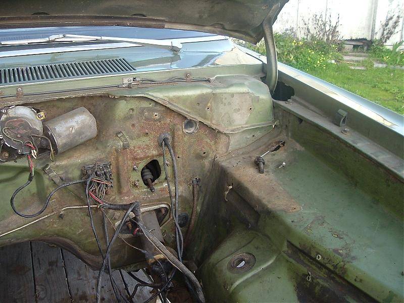

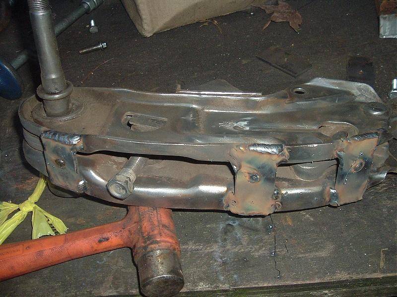

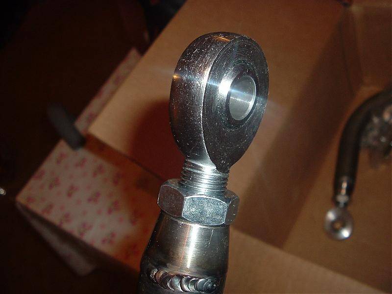

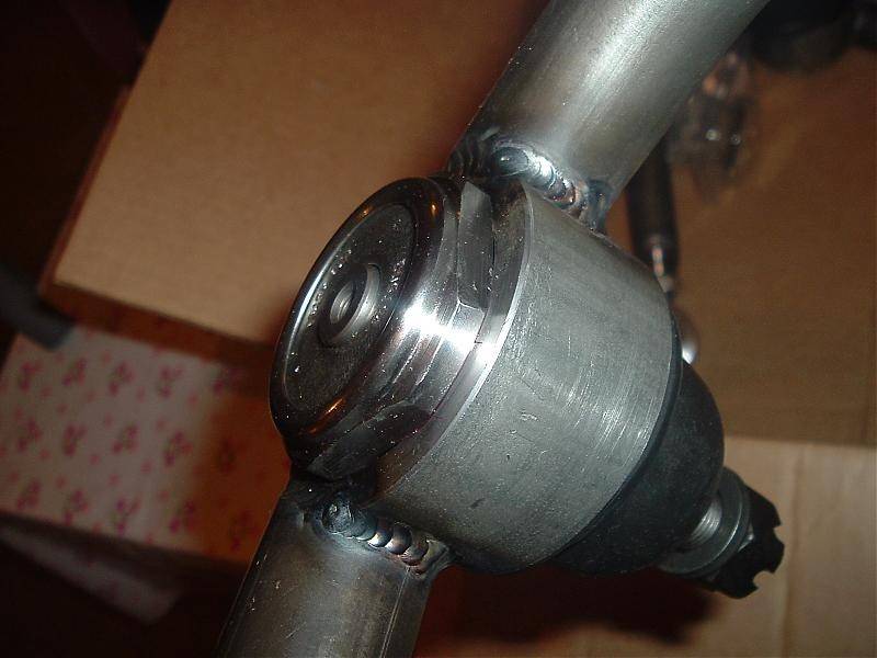

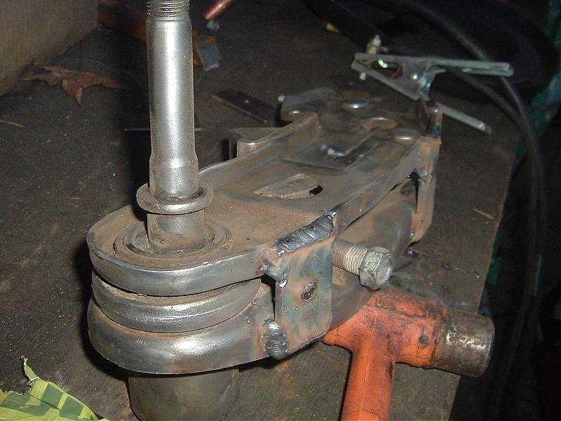

Well Worked on the old dart again this week. Got a fender and the hood off... man, taking a hood off by your self kinda sucks!! Got more of the suspension off and reinforced the lower arms. Is there something else I can do for the mounting point for the lower ball joint?? It looks like a potential weak spot for wheelies:-D.

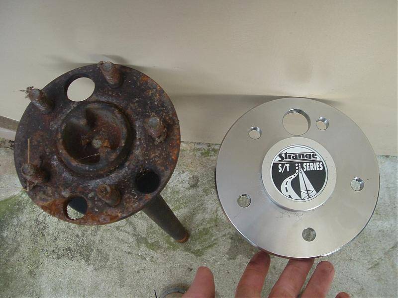

Got the Strange axles with the dana bearing kit last week. Axles were about $396 with 1/2 studs, bearings and retainer plates. All the carrier bearings, races, pinion seal and ring gear bolts was $110

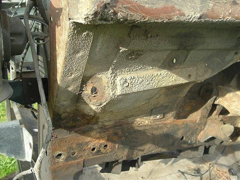

I found a new best friend.... paint stripper! I tried using a knotted wire wheel on the old undercoating, that just basically covered me in undercoating. Chemical strippers work! I just bought an aerosol can to try it out... I'm sold, I'll be buying a gallon or so tomorrow and going to town.
Your using chemical stripper on the undercoating? What kind and where to you get it? I am using a heat gun and scrapper... Time consuming but ir works. If the chemicals work pretty quickly I will try it out. Of course I am on hold until warmer weather for now.
I can't remember the brand name but they sold it at Home Depot and some other local hardware stores. You could buy in a really handy aerosal can or buy the gallon jugs. I haven't worked on it in a long time and hopefully will be bringing it to my new garage. But if you use the chemical use it in a well ventilated area AND use a mask... I was outside using it and after about 3-4 hours of use I had a sore throat for 4days after.
