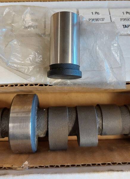

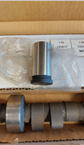

I ran low 10’s in my Dart with one (.695) back in the 1980’s. TRW pistons, stock rods and crank, 906 heads, and a TM7 and an 850 Holley.

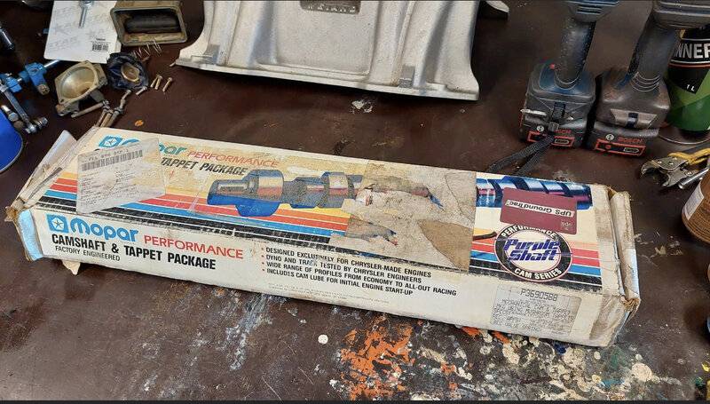

Factory mopar mushroom cam/lifter kit? Wow. I’d like to see the cam specs.
Well I`ll be the first dummy to ask, how does that even work?
I assume the mushroom part is bigger than the body and would have to be installed from the bottom?
Yes. The block must be spot faced on the bottom of the lifter bores for the shroom part to fit properly.
Those cams are badass. Old school cool at its finest.
Too much cam, too little knowledge and skill, my big block mini express mushroom went flat. Sure wish I had the chance to do it all over again......
Sure wish I hadn't thrown the cam and lifters away. (Saved the battleship springs!)
I had my maxwedge block spot faced for my mushroom. Turned out it was completely unnecessary.
Better safe than sorry. Imagine the carnage that would ensue if not done and it needed it.
Yep, you got it. Flip the block over, throw in the lifters, install the cam with the block upside down.
(Coincidentally, the same way you do it with a 1933 imperial engine)
I was looking at doing mushrooms on a slant six. Problem was getting a cam ground to take advantage of them.
Then of course you need to be careful, some mushrooms are poisonous :)
I could do mine in the car. I made a half moon tray that I could slide in the cam tunnel. Slide one in and hold the lifter up with my moms clothes pins.
