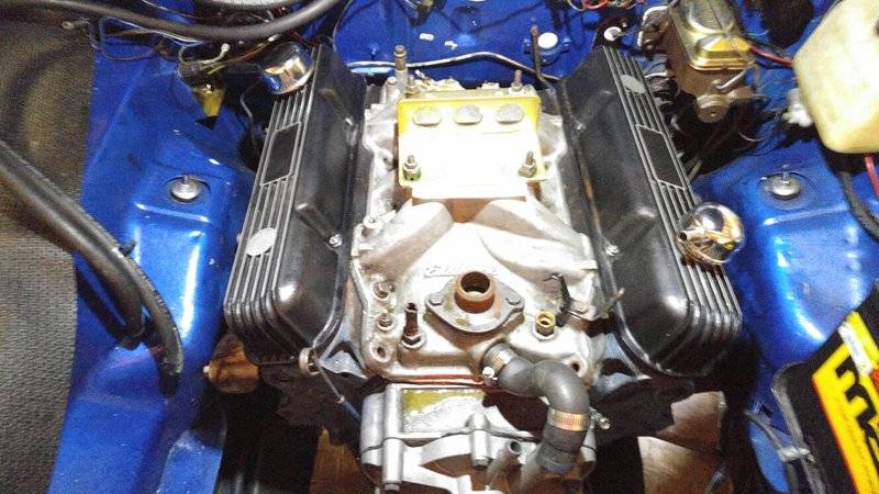

I refuse to hang 750 + pounds off any intake. Screw that , I will use my chain
Heat the intake with a torch while the motors' hanging.
That's how tunnel rams are made
nice tip! Not often someone lets out one of their little trade secrets around here.
750 lbs? The only mopar engine that weighs anywhere near 750 lbs that's a possibility for these cars is a 426 street hemi. 273/318/340's are ~525 lbs, 360's are listed at 550 lbs, 361-400's are 620 lbs, 413-440's are 670lbs. And a 426 street hemi is ~765 lbs.
I pull em fully loaded , transmissions and all, not to mention the tugging and pulling I do. I will always use a chain.
that's on there wrong - holes go front to back - they work like a charm! it ain't nuthin' but a thingIs it a bad idea to lift the motor using a carburetor plate with an aluminum intake?View attachment 1715007541
