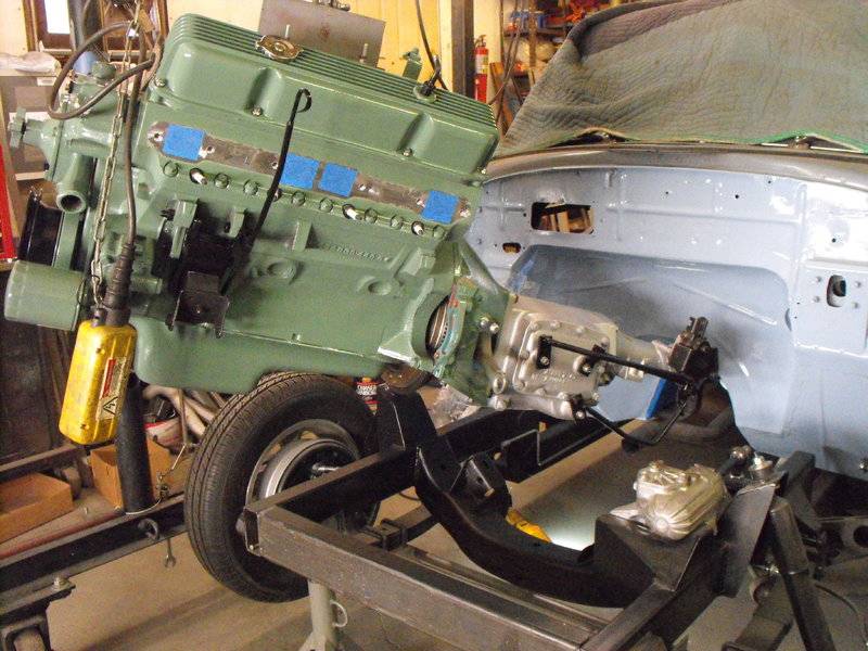

Lotta weight, no problem. Heavier homemade lifting plate though.
