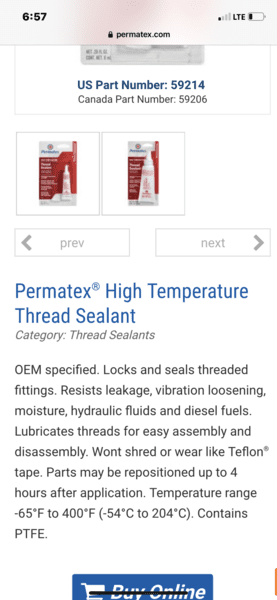

Get a tube of this. If it don't work, I'll eat my hat.
And if it doesn’t work, I’ll eat that hat after you pass it. :eek:
Others need to pay attention to Permatex’s description on how this stuff works, the workability after applying, cure time etc.
It’s the correct sealant for the application and not debatable, but you, I and others already know that! :lol:
And if it doesn’t work, I’ll eat that hat after you pass it. :eek:View attachment 1715777269
Others need to pay attention to Permatex’s description on how this stuff works, the workability after applying, cure time etc. View attachment 1715777270 It’s the correct sealant for the application and not debatable, but you, I and others already know that! :lol:
