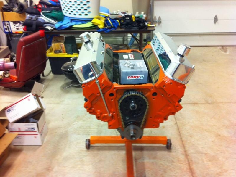

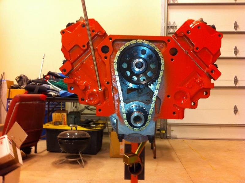

This one is the one I used on the TT Engine, a CAMDEX True Double Roller that is 7 way adjustable at the Camshaft for degree ing the cam in.
