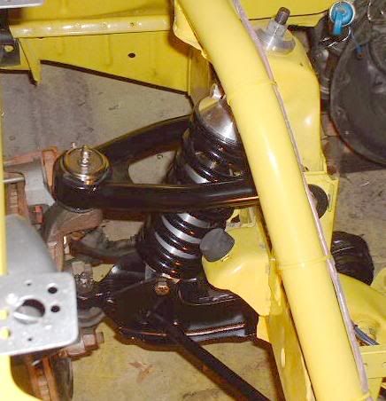

i have a rust free car 66 b cuda,,and i use coil overs,,tublar uper A arms,,,factory lower arms,,and a mustang rack and pinion,,,

the car will have a cage, tubes froom k member tied into the cage and upper shock mount....very similar to this picture

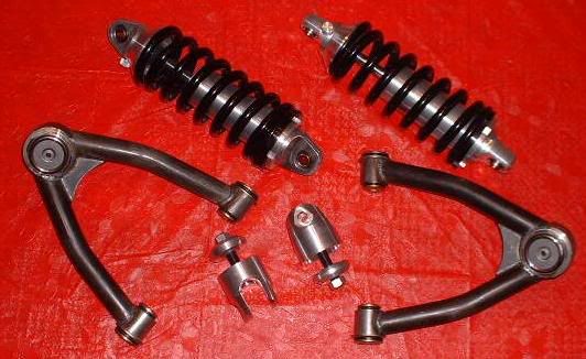

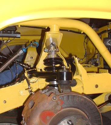

You will need upper tubular control arms for clearance of the shock and coil overs of coarse, you can use the stock lowers You just need to remove the bump stop metal that is on the frame or the spring will rub on it and the bump stops need to be thinner.Some guy have left the stock shock towers but I would suggest bracing them.You can fab a bolt on the back of the LCA so it won't walk toward the rear of the car but some don't bother and have had no problems.
All these parts cab be bought for bill at RMS just give him a call and he will hook you up with the parts you need I think he said around 400-500 dollars
Here some pics of Duster Dave's old car (The stuff is from Magnumforce which is expensive I would on buy the billet end mount if your worried about changing the shock bushing after a few years they start to wear out)

If your doing a cage I would run bars in the front tying into the shock tower and cage
Darwin, go to www.magnumforce.com. They have the coil over conversion
you are looking for. You will need the upper control arms they sell. Hope
this helps. Not a complete new K-frame, so in the scheme of things, not
that expensive.

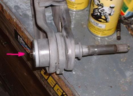

The other issue you will need to deal with is the torsion bar keeps the lower control arm in place on the k-member if the rubber bushing fails and if you plan on using poly bushings there isn't anything to keep the lower control arm in place with out the torsion bar.

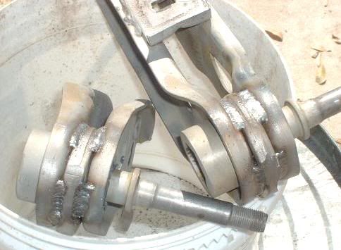

Sorry but I wouldn't trust that setup with any serious driving. That can't be more than a 7/16 bolt and the right pot-hole and bang, its broken off and your SOL looking for a place to go. If you are going to do it, do it right and not something that will get you or someone else hurt or killed.
If your car is as rusted out as I'm imagining, either go with a total aftermarket setup or find another car. At 60 MPH the ditch comes up faster than you think! It's not worth the chance!
