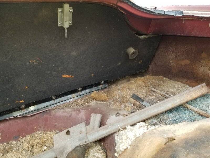

This is the divider for a 1965 Barracuda, and as far as I know it is the same for the 64 and the 66, if not someone will correct me.
Norm

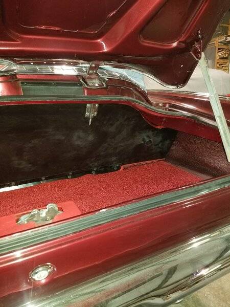

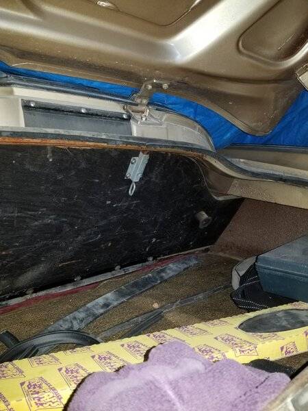

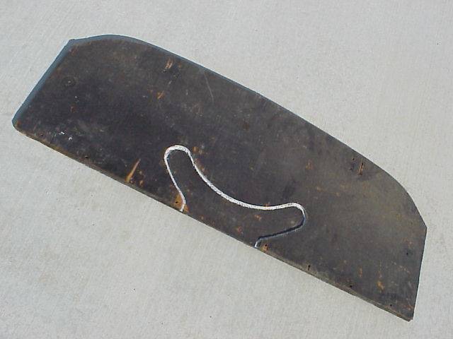

pics! The 65 could have had the optional "S" divider with the routed out fatter spare tire clearance scallop. Where did this extension go? Most likely on the right side as the jack was on the left. Ohh ****, I think I found one! see extended panel toward passenger side? Also note trunk prop rod. Debate on why Chrysler went to springer prop instead of ratchet, maybe to reduce warranty claims of bent trunks! My springer was a April 1 '65 build L.A. plant. Wow, this example is clean minus the tacky shackles!
^^^ good question. That would force the defrost blower to recycle warmer cabin directed air instead of cold trunk air. I kinda like that option, less area for stuff to collect in rolling around in the trunk. Also makes a nice stash area. :-)

This is what my 65 "S" had (originally)... but when I redid the trunk divider flap I made it like a 64 parts car I once had with the extention over the passenger side rear wheel well, and as Pishta said "it Also makes a nice STASH area " (I like that & hide things back there when I do Open Trunk Lid type shows) and since I had the trim anyways... and yes, I also made it with the Fomula S fatter spare tire clearance scallop! I could always cut the extention off later if I decided I did not want it...
