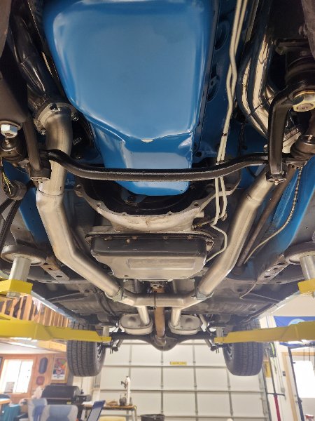

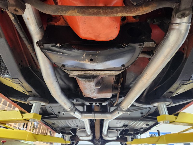

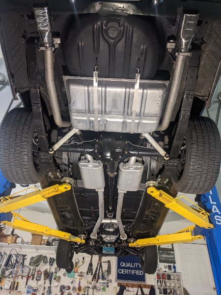

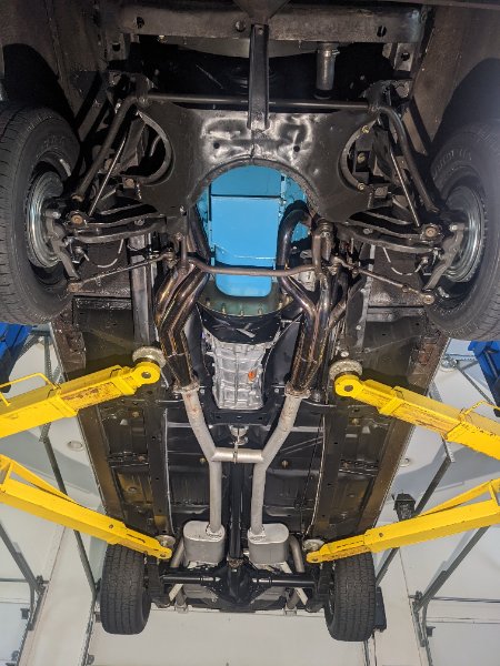

if you look at both pics the whole exhaust is there. Over the axle 1 piece and h pipe mid section also tips and all hardware except mufflers
