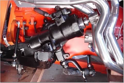

Ok guys, some quite a bit of work last weekend on the Dart to prep for engine install. I'll start with the engine mockup which I did several months ago. With the TTI headers you will need the clocking starter. I got mine from Jeg swhich saved me a few bucks. If using the 340 bell housing you will need to trim off the casting extension on the driverside of the BH. It's in the instructions. I also found that the bolts you get with the headers are both too long and are hard to start. I'm going with ARP header bolts. Don't forget, the trans crossmember has to be notched if you want your exhaust to run tight up and not hang down. On the brakes, I'm running kelsey Hays 4 disk calipers. The stock location for the prop valve will not work, too close to the headers. Because I am running a 4 speed NHRA says you have to re-route your brake lines away from the bellhousing. What I did is order a Prop valve for the 68-70 A body and ordered ca bracket from Right Stuff Inc. (part number PVB 71). The bracket mounts beside the M/C. I then ran my front brake line toward the front of the K member and along the passenger side to connect to the passenger side caliper. As soon as I get the lines back from having them flared I'll install them and take a picture. One thing is for sure running headers on an early A body ranks up there with V8 Vega and early Mustang big black header install.
I forgot to add that I got the prop valve from Right Stuff Inc., part # PV71. This is the common valve used with Kelsey hays brakes.
Did you mock everything up including your z-bar and clutch fork?

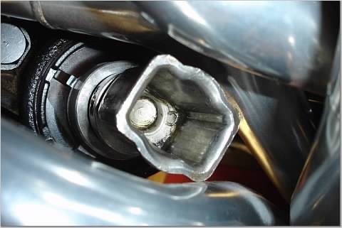

I read the instructions from TTI "1963-1966 A-bodies equipped with Standard Transmission with floor mounted shifter and Auto Transmission with floor mounted shifter." and totally forgot that my car was a column shift with power steering. The power steering is no issue at all, but the pot coupler gets in the way. :tongue2: Damn it. Another thing to buy. I guess Flaming River will be getting a new order soon. Oh well, I had sorta planned on getting one anyways just because they are so nice and makes things easy. Screw rebuilding the pot coupler now. That seemed more of a PITA than picking up the phone and laying down the debit card.

Coupler hit tubes
Uh Oh...I am about 4 weeks away from mocking up may 340 swap into a 65 Dart. As soon as I saw this post, I ran out an looked at my car and the orientation of the coupler seems to be the same as yours on my current power steering.
I just got off the phone with TTi (Mike) and asked about this. He said that they have since corrected that clearance problem. I bought my headers a month ago and he said that I should be fine. I'll let everyone know how it goes on my swap.
daves66valiant, I'm sorry to hear that you have to shift gears to solve another problem. It seams like every time I think something is going to be a direct fit, I have to modify it or fabricate something altogether different. Ah, the fun of early A-bodies....
It might still work. The engine is probably not level and inthe recommended position yet. I'll update later once the engine is in the car.
